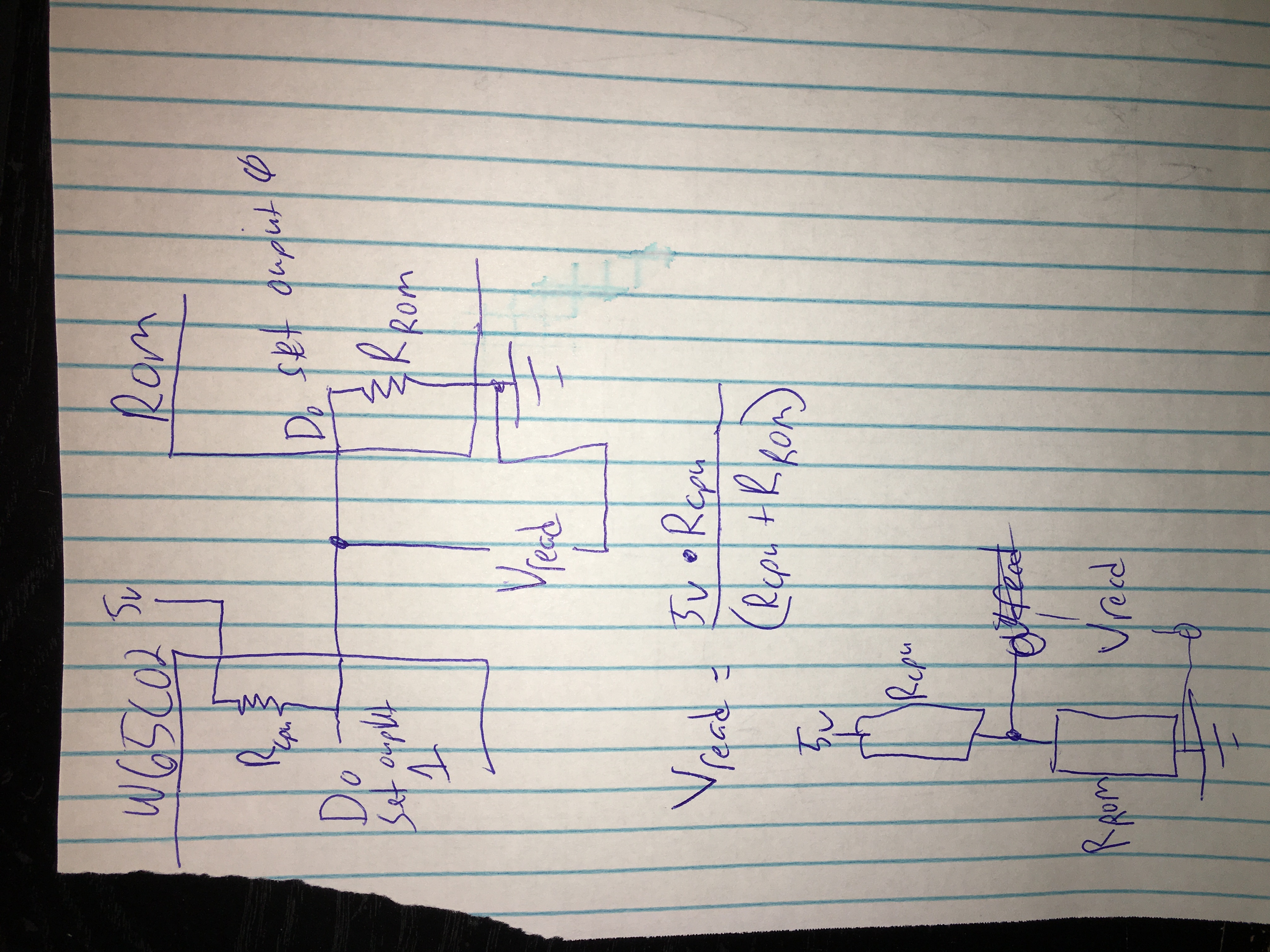

The ROM doesn't need to pull the line all the way down to 0 volts. It only needs to pull it below the threshold to be considered logic zero. It doesn't have to pull all the way to ground. The the cpu has a certain resistance to 5 volts when its set to output 1. And the ROM has a certain resistance to ground when its told to output to 0. This is a voltage divider, and the ratio of those resistances is going to determine the outcome. The magnitude of the resistances will determine the current. This is of course a very simplified way to look at it. The devices use transistors on the outputs, not simple resistors, but they still have an impedance, or resistance through them. You can't simply say that the W65C02 is capable of pulling the sun into the earth without also considering the traits of the sun. There's more than one device in the circuit. You must consider the ROM as well.
Edit: So if we add in what Garth told us about the high drive capability of the WDC 65C02, that probably means it has a pretty low resistance to 5 volts when it is switched on to a logic output of 1, and a low resistance to ground when outputting a 0. This would allow it to source or sink more current without heating up, drive longer lines and push pins set up as inputs around a bit easier even when conditions are not ideal. But this would put the the WDC in a disadvantage when in a battle of the outputs like this with a device that has a higher resistance that is driving the line as an output.
attached is a very rough sketch

Yes, thanks for elaborating, CaptainCulry. The two devices in contention create a voltage divider, and there'll be a non-zero voltage which is nevertheless reported as zero by the Logic Analyzer.
whatever voltage remained on the data bus pins was low enough to be seen by the LA as zeros
At a more usual operating frequency (eg: 1 MHz), a single cycle of contention would be sufficiently brief that the power supply probably wouldn't collapse. But speculatrix mentioned running far more slowly, ie, 1 Hz... :|
... which, in light of his tag line -- "I like it when things smoke" -- almost seems like an attempt at wish fulfillment! :lol:
ps to BillO: good point about CMOS logic levels. These would "help" the LA to mis-report a low-ish voltage as being zero.
Yes; perhaps I should have said that what I measured was that the WDC parts could pull to within 0.8V of either rail at 19mA per pin, but there was a current limit of about 50mA when shorted to the opposite rail. I still need to go back and find the details to check on; but in any case, it's not just a resistor. The Rockwell 65c22 VIA OTOH was a little different. I could not pull up quite as hard, but it would give you 100mA (per pin) if you short a low output to Vcc!
That sketch does not look correct to me. The formula for a voltage divider of the form
 +5V ---- R1 ---- Vout ---- R2 ---- GND
is
               R2
Vout = 5V * ---------
             R1 + R2
You seem to have the wrong term above the bar, you should have Rrom up there instead of Rcpu. The lower the CPU's internal "resistance" as compared that of the ROM, the higher the level at Vout will be. (And this makes sense when remembering that V=IR: the current is the same at all points on that line, so the bigger resistor must be dropping more voltage.)
That said, there's a lot else going on there that is not taken into account in this simple model. I would not be surprised if, though the WDC part can source a lot more current than the ROM, the ROM is capable of sinking considerably more current than it's sourcing, making the line asymmetrical such that whichever wants to pull it towards zero will "win." Further, both the 6522 and the the Amtel MCU on the Arduino are directly connected to that line as well, and thus they will also be sinking some current from the line (though I don't know how much difference that would make).
