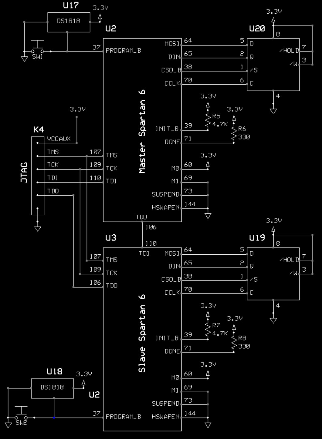

So for the FLASH PROM's I just applied more flux and hit each pin with the soldering iron. I think that's what I'm going to wind up doing for everything. I tackled some 0402 passives using the hot plate and heat gun. The flux kept the parts from being blown away. Then I let it cool down, reapplied some flux and hit each end with the soldering iron with the slightest bit of solder on the end.
I'm almost done with the JTAG section. 4 0402 resistors have been soldered in, the DS1818's with internal 5.5K pull-up resistors are soldered in. I believe all that's left are the reset buttons, the FPGA's and the JTAG connector. Ah, and the voltage regulators which I still have to order.
Here's the schematic for the JTAG section. I realized I made an error on the silkscreen labeling the Master and Slave reset buttons. They're switched.
I'll have some more pics after I solder in the FPGA's.

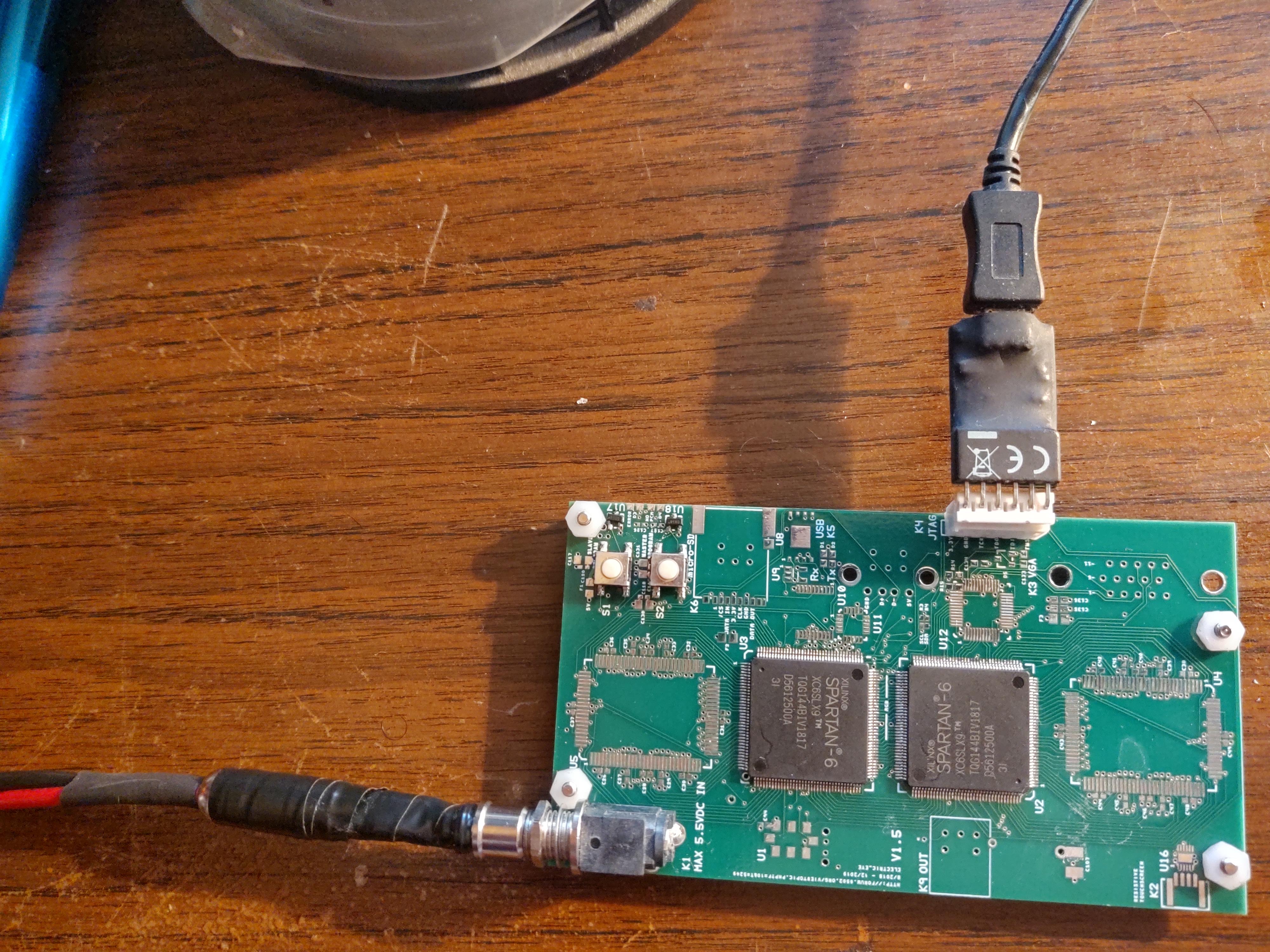

PostPosted: Thu Jan 09, 2020 12:01 am
Still working out the ISE 14.7 install... iMPACT is not being installed for some reason, so I can't test the JTAG yet. Seriously pissing me off,,, I have to bring my old machine back up and reanalyze this whole PC failure situation.
Today I've installed the JTAG connector and took 2 pics with the 5V 11A power connector. That power is coming from an old ATX switching power supply. Plenty of current and good regulation. Be patient with this old geezer!
