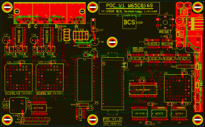

PostPosted: Thu Dec 26, 2019 2:54 am
Posts: 8505
I've completed a preliminary design for a unit I've dubbed POC V1.2...As for actually building the contraption, I face a conundrum...a DIP design will result in a large PCB...
A design using DIP packages worked out to 30 square inches (76.2 sq cm), and that with everything tightly jammed together, not particularly good for trace routing. A design with SOIC packages works out to 24 square inches (61 sq cm) and that's with more comfortable parts spacing. If this thing is going to get built it will have to be with the SOIC stuff.
File comment: POC V1.2 PCB
BTW, some of that seemingly wasted space on the above board may eventually get used. I made the board perimeter somewhat larger than needed.

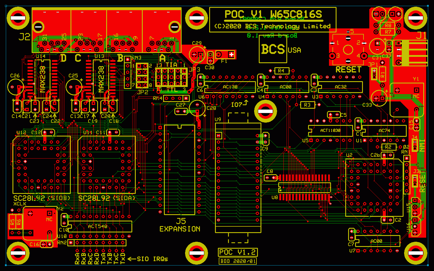

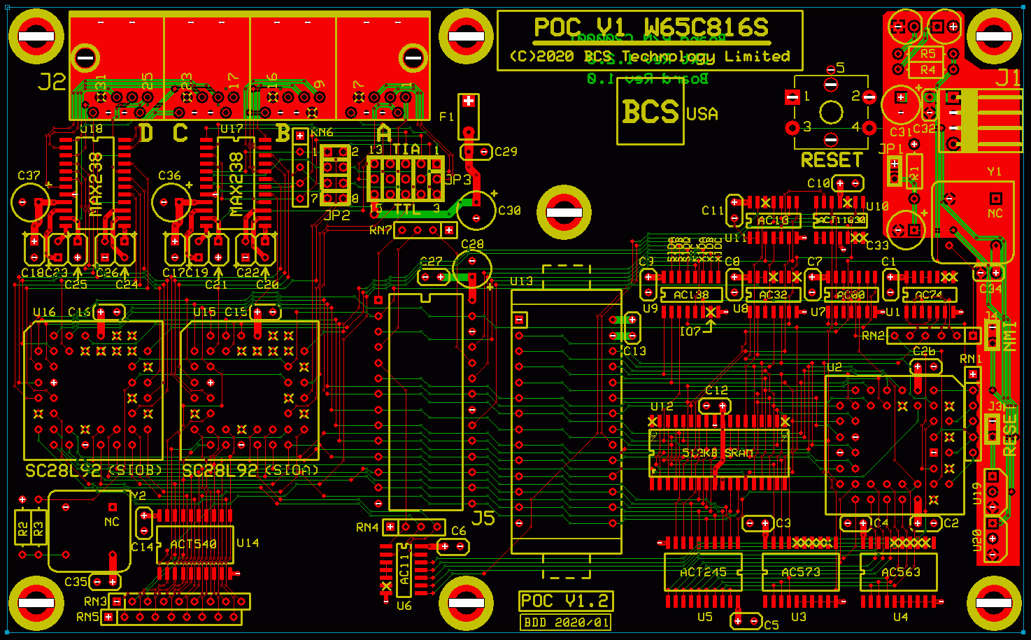

PostPosted: Sat Jan 04, 2020 12:48 am
Posts: 8505
Upon sleeping on this a bit, I re-evaluated my goals and decided to simplify the design. I removed the extended addressing function, as it isn't germane to BIOS development.
The main purpose of building V1.2 is to create a machine on which I can concoct a virtual QUART (vQUART, vQUART meaning "virtual quad UART") driver, as well as a BIOS API that is called with software interrupts instead of subroutine calls. As long as I have a reasonable amount of ROM and bank zero RAM available it will all work without the complication of extended addressing. Eliminating extended addressing means less glue logic will be required, which means fewer gates and hence more timing headroom. It also means I can use a smaller SRAM. Fewer gates means fewer chips on the board, which, as you will see, will allow me to use "vision-friendly" DIP packages for all logic devices (alas, the SRAM is only available in SMT, and space constraints require that I use the SOIC version of the MAX238 transceiver). Below is the schematic and PCB for this unit:
File comment: POC V1.2.1 Schematic
poc12.pdf [306.33 KiB]
Downloaded 101 times
File comment: POC V1.2.1 PCB Layout
The vQUART consists of two NXP 28L92 DUARTs whose driver will make them appear to be a single QUART to applications that access serial I/O (SIO) through the BIOS. Of the four SIO channels, channel A will be the console channel, channel B will be a hardwired link to my Linux software development machine, and channels C and D will be uncommitted. A BIOS call for SIO services will use the .X register as the zero-based channel index, which is convenient for higher-level applications. As is the case for my DUART drivers, everything will be interrupt-driven and will take full advantage of the 28L92's 16-deep FIFOs.
Speaking of interrupts, the 28L92 can be configured so general purpose output pins 4, 5, 6 and 7 (OP4-7) act as open-drain IRQ signals. OP4 is wired to the RxD channel 1 IRQ, OP5 is wired to the RxD channel 2 IRQ, and OPs 6 and 7 are wired to the channel 1 and channel 2 transmitters, respectively. When the 28L92 interrupts with its main IRQ output, it will also pull one or more of these pins low if reception and/or transmission activity was the cause of the interrupt.
In order to take advantage of this feature, I have the OPs wired to the inputs of a 74ACT540 bus driver, with bits 0-3 wired to the receiver IRQs and bits 4-7 wired to transmitter IRQs—bits 0 and 4 are channel A, bits 1 and 5 are channel B, and so forth. The bus driver is assigned a location in the I/O map (designated SIOQ) which when read, will return a real-time IRQ status. If %00000000 is read, then no receive or transmit IRQs were generated. Otherwise, bits will be set according to what interrupted. These bits are real-time, meaning they stay set until the cause of the IRQ has been cleared.
This arrangement doesn't report the cause of other vQUART IRQs, such as timer underflow, which must be detected by reading the individual DUART interrupt status registers. However, the interrupt service handler's work will greatly reduced, since no polling of each receiver and transmitter will be required. This reduction becomes important when one considers that if all four channels are simultaneously receiving and transmitting at 115.2Kbps, as many as 46,080 IRQs due to SIO activity could occur in one second, assuming an IRQ occurs with each datum received or sent. In practice, the rate won't be quite as severe, due to the buffering provided by the DUARTs' FIFOs. In the best case, 2880 IRQs would occur each second of continuous bi-directional communication, as an interrupt will only come when a receiver FIFO is full or a transmitter FIFO is empty.
Having two 28L92s in the circuit means I will have two precision timers (timers A and B) available, with timer A generating a 100 Hz jiffy IRQ for timekeeping purposes. I've yet to come up with a use for the other timer, but I'm sure I'll think of something. A useful feature of the 28L92 is the timer's output can be directed to the OP3 pin to drive something external—a pullup resistor is required to use this feature. In timer mode, a continuous square wave equal to the timer's underflow rate is produced, where as in counter mode, OP3 is high until the timer underflows, at which time it goes low.
As well as developing the vQUART driver, I will be implementing an interrupt-driven BIOS API. Instead of calling a BIOS API function with JSR, the COP instruction, along with an API function value (API index), will be used to cause a software interrupt, which will be intercepted by the BIOS. There a couple of ways this can be implemented:
  1. Use COP's signature byte as an index. This method is analogous to the method used in PC hardware to call BIOS services. It has the advantage of not using any of the registers, leaving them free for passing parameters. It has the disadvantage of requiring convoluted bank-twiddling operations in the BIOS' API front-end code to fetch the index, producing relatively slow performance.
  2. Push the index to the stack. This method also has the advantage of leaving the registers available for parameter passing. Compared to method 1 above, this method has the disadvantage of requiring that the caller push the index, which is an extra step in calling the API, as well as API front end activity to fetch the index and rebalance the stack.
  3. Pass the index in a register. This method has the advantage of having the least effect on performance, as no stackrobatics or bank twiddling is required to pass and fetch the API index. It has the disadvantage of using a register, which means parameter passing is made more complicated.
In POC V1.1's BIOS, only the registers are used for parameter passing, as no function requires more than three parameters. Obviously, if more than three parameters must be passed there is going to be a problem. Which of the above methods to use is something I will be kicking around as things progress.
In any case, the value of using a software interrupt to call API services is it is bank-agnostic. In a system with more than 64KB, a program can call the BIOS API—which must be in bank zero—without having to do anything special to compensate for not being in bank zero. This will be a very useful feature when I finally get a machine with more than 64KB running.

BTW, here is the current board layout.
File comment: POC V1.2 Printed Circuit Board
By pushing around the board perimeters here and there, I was able to use DIP for all of the glue logic—only the SRAM and the two MAX238s are SMT. I even found enough room to rig up a "heartbeat" indicator (bottom of PCB in between center and right-hand mounting holes). :D The heartbeat circuit is hooked up to the MPU's /IRQ input, so when there is IRQ activity the LED will flash. This feature should be useful in debugging the vQUART driver. If the LED stops flashing then the interrupt system has gone belly-up.
During the revised layout exercise, it became evident that mounting the SRAM north-south would be more space-efficient than east-west. As it turned out, doing so slightly reduced the number of via required, meaning fewer holes and hence some cost reduction in the board (not much, but every bit helps). This SRAM layout is very similar to what I used in POC V1.1.
As part of this project, I've developed a new board layout for anything that plugs into the expansion port. My original layout was an "after the fact" concoction meant to add SCSI to POC V1.0 by using the real-time clock socket as the expansion port. Accordingly, I had to work within the layout constraints of that design. Since I had to reshape the PCB to accommodate the V1.2 circuit design, I decided it was time to come up with a more sane expansion board layout. My first use for it will be a new SCSI host adapter design with active termination and support for higher bus speeds.
Farther down the road before I put POC V1.x back into the closet is to develop a version that uses a real QUART, instead of the vQUART in this design. In the vQUART arrangement, the registers of the two DUARTs are not contiguous in the I/O memory map, which adds some complication to the driver code. The QUART's 32 registers will be contiguous, which aside from simplifying the driver, will free up an I/O select. The QUART has an interesting interrupt arbitration feature that I'd like to try to get working, plus it has additional outputs that can be used to report almost all IRQ sources in hardware.
First step is to get V1.2 upright with a pulse. That should happen soon.

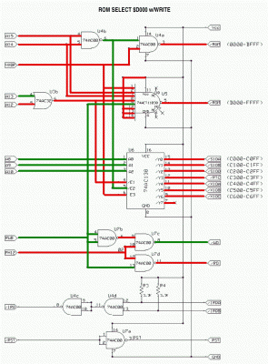

Something I had started doing a while ago was generating color-coded drawings of the logic circuits of my projects in an effort to catch design errors. So I did with POC V1.2.
V1.2's memory map is different than V1.0's and V1.1's. In the latter machines, RAM runs from $0000 to $CFFF (52KB), I/O from $D000-$DFFF (4KB) and ROM from $E000-$FFFF (8KB)—this is a "classic" 6502 memory map. As I added to the firmware in POC V1.1 it became clear that I was severely crowding that 8KB of ROM—the end of the firmware is at $FF50, which is only 144 bytes away from the start of the 65C816's hardware vectors at $FFE0.
The 27C256 ROM I use is a 32KB device, which means I have an unused 24KB. Mapping in another 4KB of ROM would give me the headroom I need for my planned firmware additions. With no need to maintain backward compatibility with V1.0 and V1.1, I decided to revamp the memory map, which is now RAM from $0000 to $BFFF (48KB), I/O from $C000 to $CFFF(4KB) and ROM from $D000 to $FFFF (12KB). Further to this, ROM will only appear on a read cycle—a write to the ROM's address range will go into the bit bucket.
After going through several iterations of glue logic, I came up with a circuit that meets my (unofficial) dictum that no more than two gates should be between the address bus and chip selects. With 74AC logic, this works out to an average of 14ns delay from address generation to chip select, more than enough timing headroom to support 14 MHz operation (although that technically isn't possible with the 55ns EPROM I am using). In order to prove on paper that the glue logic would work as required, I color-coded four possible machine states: RAM select with write¹, I/O select with write, ROM select with read and ROM select with write.
File comment: RAM Select at $BFxx, Write Cycle
File comment: I/O Select at $C000, Write Cycle
File comment: ROM Select at $D0xx, Write Cycle
File comment: ROM Select at $D0xx, Read Cycle
In the above illustrations, the net symbol VADR is the logical OR of the 65C816's VDA and VPA outputs, which means VADR goes high when the '816 is generating a valid address. All chip selects are qualified by this signal to avoid confusing devices with temporarily bogus addresses generated as the '816 sets up for the next operation.
The above glue logic is adaptable to the 65C02 with two changes: replacement of the 74ACT11030 AND gate with a 74AC20 and removal of the VADR logic, which has no analog in the 65C02. Note that the SRAM must be at least 48KB.
¹I belatedly noticed that I mixed up the color-coding for A14 and A15 in the RAM select illustration. So the actual address would be $7Fxx, not $BFxx. Either way, the logic does work on paper.
