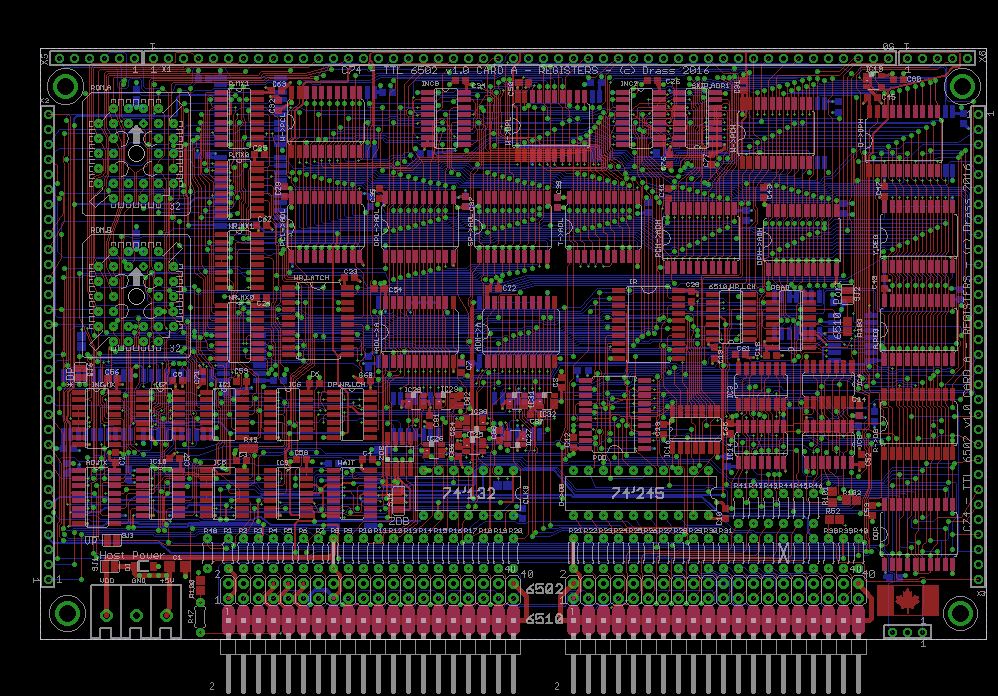

But would the clock need gated? Could you keep the clock going and only use a transistor/latch to just unhook it from where it feeds the program counter while keeping the clock on the rest of the CPU? Not sure, just wondering.
For room, if you need 2 more chips, it seems that they can be added to the socket end on the header board.

Ah, my mistake. I assumed gating the clock was the intention (the schematic ttlworks pointed to shows what looks to be a 74LS02 at the CPU clock input). Yes, the clock can be manipulated inside the CPU, as it already is by the RDY, STP and WAIT signals. (see Card A, Page 3 here: http://forum.6502.org/download/file.php?id=8135&mode=view).
You’re probably right, but I have to admit to more than a little vertigo at the thought ... :)

Sorry if this has already been asked elsewhere in this topic, but why are the two ICs 74'132 and 74'245 thru-hole DIP parts when all the other logic ICs are SMD?
PostPosted: Wed Feb 19, 2020 11:20 am
Posts: 1431
The 74245 buffers the external data bus, the 74132 buffers some external control signals which go into the CPU.
Logic level threshold is what separates the logic LOW voltage from the logic HIGH voltage at an input pin.
74ACT has a logic level threshold of ca. 1.3V, that's compatible to good old standard 74LS TTL.
74AC has a logic level threshold of half the supply voltage, would be ca. 2.5V at a 5V supply.
By default, we are plugging a 74ACT245 and a 74ACT132 into the sockets.
In, for instance, a C64 (running at ca. 1MHz) we could assume that the output drivers of the chips inside the computer make ca. 3V logic HIGH max.,
and that they have a logic level threshold of ca, 1.3V, so 74ACT is fine.
If it should become necessary to have improved noise immunity when plugging the CPU into a computer running at 20MHz max. built from modern parts,
we still have the option to plug a 74AC245 and a 74AC132 into the sockets instead.
If 74AC won't cut it, another option would be plugging slower chips (which might be less sensitive to spikes at the inputs) into the sockets, like 74HCT\74HC.

ttlworks wrote:
By default, we are plugging a 74ACT245 and a 74ACT132 into the sockets...
Of course - that makes sense now.

After 20 years+ of making PCB layouts for a living, I would dare to say that the PCB layouts for the CPU are the most complicated/dense design
that I ever have encountered so far, and considering that this is Drass's first project, I'm amazed/impressed that he was able to route them.
No free space left on the PCBs for implementing something like an "Atari modification", sorry.
