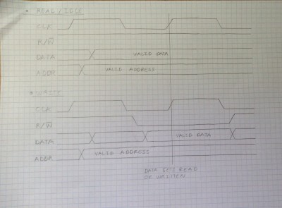

Attached is a timing diagram of the current setup. Control signals change on the falling edge of the clock, and register transfers, reads and writes happen on the rising edge. I have no Phi 1 and Phi 2, so it's quite different than the original 6502.
I am not aiming at full compatibility and I'll be designing all peripherals. Should I change the way its implemented? Any suggestions are welcome.

Very important: The 6502's cycle starts with the falling clock edge, then the processor sets up the address and R/W, well ahead of the rising edge of Φ2. Whether reading or writing, the data must be valid before the fall of Φ2 at the end of the cycle, with enough setup time for the data to be latched in at the falling edge. The timing diagrams in the data sheets have all the details.

\________/ \In my particular implementation control signals (including R/W) change on the falling edge of Φ2, and data is latched on the rising edge.
The write cycle starts at point D, on the falling edge of Φ2. Addresses have been set on the preceding rising edge, so they should be valid by this point. R/W changes shortly after, so does the data, which is valid through E and to the falling edge of Φ2 in F, when it's latched by for example RAM.
The read cycle starts in A, with valid addresses and data set beforehand. The difference here is that data is read by the CPU on the rising edge of Φ2, on B instead of C. It has to be this way, as I'm latching data on the rising edge.
I suppose this would work, there would be plenty of setup time, unless the peripheral waits to the rising edge of Φ2 to output the data that is.

Address must never change while Φ2 is high.
The peripheral will not even begin to output data until after the rise of Φ2 (except possibly in the case of ROM, depending on the glue logic); but it will have it ready ahead of the fall of Φ2.

I think I have gotten it right this time. I have added a couple flip flops and changed the microcode so signals change on the appropriate times. I had the phases swapped. Now it matches the timing diagram on WDC's datasheet. (I find this one easier to read: https://www.princeton.edu/~mae412/HANDOUTS/timing.bmp)
