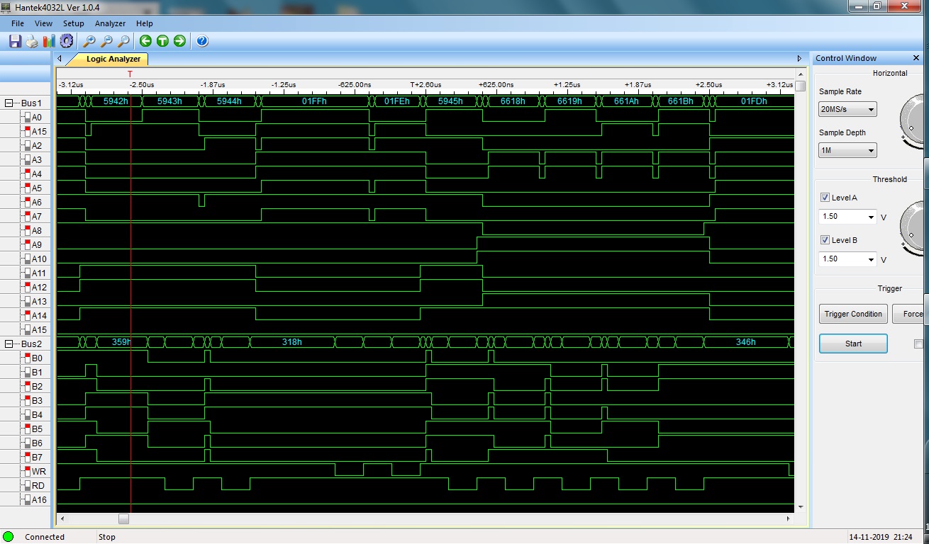

I must have been trying to hard and to late yesterday because today I started again going through the interrupt sequence and yes $4576 is there and happening frequently.I will check the timing of it and add it on after.
Interrupt starts at $2038 then $3d8C and finally $4576 A9 and ending at $45AA 60 RTS Strangely the following instruction is $45AB A5 which I don't understand unless it's reading the ROM before executing the code. Next is $3d95 45, where it was before the JSR followed by $3d96 68 up to $3d9B 40 RTI. Again the following instruction is $3d9C 48. Then the following:

So it looks the timer interrupt in software is ok and is exactly 327.2uS, just as dclxvi said it should be. Again I rechecked pin1 IC1 and there is no change to the strobe output. So do you agree the CPU port is faulty?
Pin 1 isn't the output of Timer 1. Pin 1 is strobe output of timer S, which is a 128 ms pulse. The routine at $6CCF enables the strobe output (by setting bit 4 of memory location $F5) and sets the pulse width by storing $0F into memory location $FA.
$6CCF isn't called from the ISRs, it's called from the main loop. The two paths that lead to $6CCF both begin at the JSR $6618 at $5943 in the main loop, but I haven't analyzed the routines that lead there, so I don't know under what conditions it is supposed to reach $6CCF. If you don't see address $6CCF in the logic analyzer trace, I wouldn't expect to see anything on pin 1.

Sorry about my misunderstanding. I will check for JSR $6618 at $5943 later tonight and report the results.

$5943 and $6618 are appearing in the LA trace as shown. Now looking for $6CCF

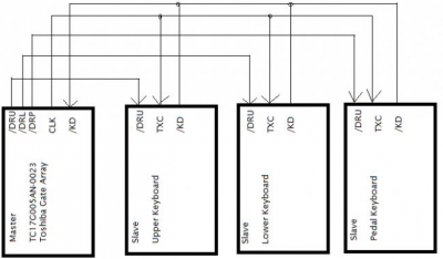

PK20L pedal keyboard: a (rotated) picture from the organ forum about the SPI like communication between the MI-1 and the keyboards:
