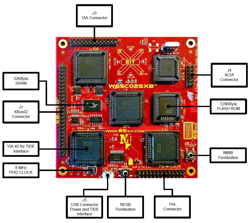

Hello all, its been a long time since I posted something. I recently picked up one of these guys: https://wdc65xx.com/Single-Board-Computers/w65c02sxb/
I'm not much of a hardware guy I'l have to admit. So, I wanted something that had real hardware that I could write my software for. So far, the WDCDB (debugger/monitor) has been splendid and worked flawlessly.

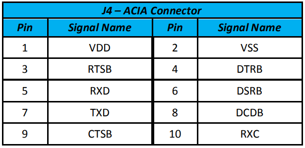

However, since I am writing my own BASIC and FORTH interpreters, I would like to be able to connect to this board over a terminal connection. The 65C51 onboard has a jumper with the following pins:
I know that RXD/TXD and ground are required, but I'm not sure about the other pins. What I'd like to go with is a null modem DB9, and just purchase a DB9 serial -> USB cable of some sort. Some of the schematics I've seen make use of the MAX232 chip.
I'm hoping that this isn't required. I was a little disappointed that I couldn't just use the microUSB "TIDE" connector to connect to the device. I'm hoping that someone out there has played with this board and knows exactly what I need to do :)

It is possible to usurp control of the USB serial connection but you lose the ability to use the WDC software at the same time.
As for the ACIA connect a jumper wire between RTS and CTS. I use USB serial adaptors connected to RX, TX and GND. I have a load of (cloned) pl2303 serial modules which can be made to work as long as you use an old windows driver. A safer bet is a newer FTDI 232RL based adapter.

So, maybe if i went with something like this https://www.amazon.com/Adapter-Serial-C ... B075N82CDL
Would I just be able to run dupont connector wires to the appropriate pins?

Yes that should work. You could connect rts and cts for hardware flow control with that board.
