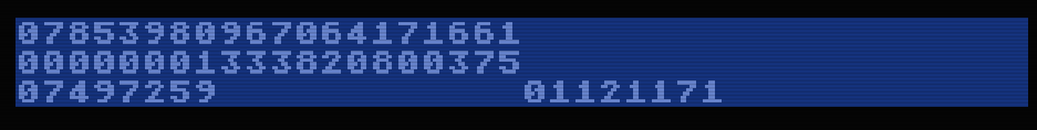

This is a good challenge.
First, there is an obvious way to calculate the required number of terms: as the series converges alternating signs, the error is always less than half the next term in the series. This means that the sum should be better when 1/2 * 4/(2*N-1) < 315/113 - PI, so 2*N-1 > 2/(315/113 -PI) = 7 497 258.185..., so N > 3 748 629.59... and the smallest N = 3 748 630.
Now, the slow answer, just calculate the sum until the result is closer to PI than 315/113. This code runs in an Atari 8-bit computer (so, available in 1979), it is a quick and dirty job using base 10 arithmetic to show the sum in real-time (as the numbers are stored in the screen).
Using 20 digit numbers, it finishes in 5 hours with 12 minutes, 28722673559 CPU cycles. The numbers printed are the current sum/4 , the last added/subtracted term, the value of "2*N-1" and the time in frames, NTSC Ataris have 59.92271 frames per second.
Screenshot from 2019-09-07 22-58-22.png (5.22 KiB) Viewed 2287 times

Here is another attempt. Runs in about 11820 megacycles.
Developed in FORTH on a 65816 in native mode. The calculation routines are 8-bit internally to simulate a 6502.
F_AsimovPiQB_6.txt
Simulator console log
(23.2 KiB) Downloaded 212 times
