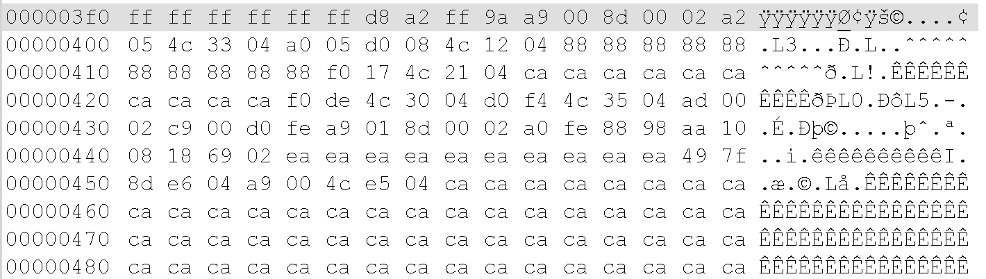

I was able to download version 1.42 from the archive. I unziped and tried to assemble the functional test and everything went smoothly without syntax errors or anything. However, the program is starting at 0x3F6 instead of 0x400 as expected. I tried adjusting my emulator to start at that address and everything fails badly within the first few instructions. I guess this is expected given the offset. See the attached picture. I assembled by running the following command: as65 code.asm
I also made a listing file by running: as65 -l -h0 code.asm
and the listing says the code segment starts at 0x400. Am I doing something wrong here?

It might be that you need to build differently. Perhaps experiment with this setting:

No dice. I wonder if it has anything to do with the fact that I am running win10 64-bit. I will try the DOS version with dosbox.

You definitely have some sort of offset in the object code. This is what the official build shows at $0400, preceded by a block of $FF bytes:
00000400  d8 a2 ff 9a a9 00 8d 00  02 a2 05 4c 33 04 a0 05  |...........L3...|

That's right. I tried the DOS version of the assembler and the result is the same. It is offset by 0xA bytes. The ORG directive is pretty straight forward. If code_segment is defined at $400 the code should start there. For some reason it is not.
I already tried all possible configuration combinations. The composition of the file definitely change with some configuration options.
I will write a little program to see if I can duplicate this behaviour.

What happens if you include:
ORG 0
 DB 0
…or whatever equivalent works in that assembler? That should force the image to start at address zero.

Chromatix, it seemed very strange to me that Klaus' first defined segment was at $A and the assembled code was offset exactly by this amount. As you mentioned, I added an org 0 directive to force the assembler to output the remaining bytes and everything is working perfectly now.
I disabled the decimal tests and my code gets trapped at the success infinite loop.
I guess the the file was originally assembled using a switch that does just that. I dont see it in the manual though!
It's funny that the listing file generated is correct even without the padding. sounds like a bug?

Generally an assembler is designed to produce a program that *doesn't* start at address zero. This is especially true on the 6502, which treats addresses $0000 to $01FF specially. ROM images, in particular, will start at some high address like $8000 or $C000, and it makes sense to emit a 16KB image to fit a 16KB device (or a pair of 8KB devices) rather than fitting the entire 64KB address space.
So it sounds like it's taking the lowest address specifically defined in the listing as the start of the binary image. Klaus' test suite is simply unusual in terms of which bits of memory it pre-fills.
