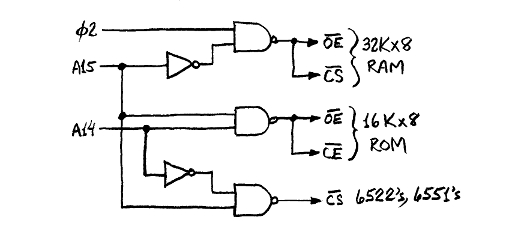

What I've "settled on" over the last week is something like the following:
Half (*1) a 139 to manage Phi2 and R/W into /OE and /WE.
A15 to /CS of a 32kx8 SRAM (I have a CMOS one someone gave me years ago - that'll work with an old NMOS 6502?).
A15 to G1 of a 138, with A14-A12 decoding the top 32k into 8x4k (*2).
(*1 Later, maybe the second half of the 139 could cut a 4k into 4x1k, and the VIA's and two more "future" IO could be there.)
(*2 Making that instead 2x4k and 3x8k was what led to my original question. I've dropped the idea, thanks.)
Giving:
4k ROM
4k VIA
4k VIA
4k "future" x 5
32k RAM
... with just 2 cheap chips of glue. Simple for now, room to grow.
Making a clock was the next question, but I found a thread on the Arduino forum which gave a nice routine to divide the 16MHz clock of the Arduino by 16 and give a nice square wave ... I have a bunch of Arduino's so that will be an easy temporary solution. (With the Arduino's (including bare Atmel IC's) I'd been thinking of ways to use them with this, e.g. as an "IO processor" to handle I2C and SPI ... but that kind of feels like cheating so this Arduino-as-clock will hopefully only be temporary.)
What I will be using an Arduino for, is EEPROM programming. I have the I/O expanders I need, and have ordered some AT28C64B-15PU to try.
Thanks everyone.
Most SRAMs will work with either CMOS or TTL inputs. To be certain of that, look up the datasheet by part number, and examine the DC Characteristics table, in particular the "input high/low" entries with VCC in the vicinity of +5V. Entries like "input low: 0.8V" and "input high: 2.2V" indicate TTL compatibility. An entry like "input high: VCC * 0.8" should give you pause, because that's a CMOS spec which a TTL output will have difficulty meeting.
A '139 demultiplexer is likely to propagate the Phi2 signal slower than the single NAND gate in the recommended 74HC00 configuration. For an NMOS CPU (which specifies an "Address Hold Time" of 30ns at the beginning of Phi1) it may well still be fast enough, but it's vital that the address lines from the CPU don't change before the /WE signal to the RAM goes high, otherwise a spurious write may occur. The 74HCT139 is *just* fast enough in its maximum propagation at +5.5V to avoid this hazard, and its "typical" specs are faster, but I would still prefer to use a plain NAND gate here - not least because it allows fitting a modern CMOS 6502 later.

pzkpfw, to follow up on and reinforce what Chromatix is saying here, if you want 32KB of SRAM, look at the next diagram in the address-decoding page of the 6502 primer:
It's faster than the '139 option, allows 16KB of ROM, and more I/O than you were thinking of. It is crucial that you get cozy with the timing diagrams and specifications for each of the parts. It's common for beginners to think these logic ICs are so lightning fast that the time required for them to respond is negligible. It's not though, and the '138 and '139 are kind of slow. At 1MHz you can get away with murder (timingwise, not necessarily constructionwise, if you're using parts with fast edge rates); but as you upgrade to a faster processor version running a faster clock, you can hit the limits way too soon.
It could be pointed out that this is not the fastest way to get SRAM service, since it's not taking advantage of the possibility to set its chip-select input true earlier when A15 becomes valid; but note that SRAM is available in much faster versions than ROM or probably any I/O ICs you'll put on the bus, meaning that the SRAM still won't be the speed bottleneck.
For clock generation options, see the clock generation page of the 6502 primer. WDC no longer tests or guarantees the delays from φ0 in to φ1 out to φ2 out; but the circuitry is still there, and I have little doubt you can still hang a crystal or an RxC directly on the processor's pins to set the clock speed. See the notes also under the first diagram of the "circuit potpourri" page of the 6502 primer at http://wilsonminesco.com/6502primer/pot ... ml#BAS_CPU .

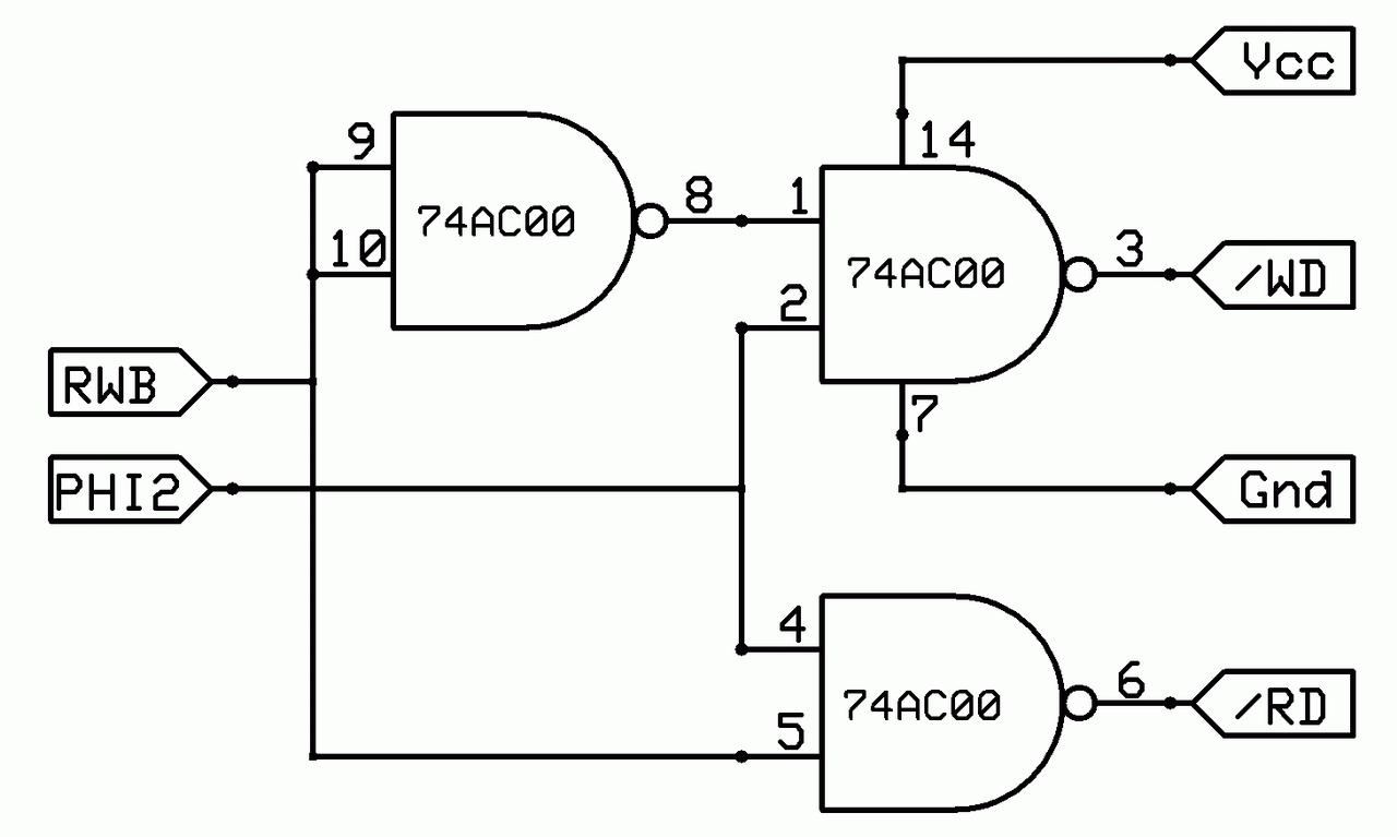

Something I studiously avoid is using the Ø2 clock to qualify chip selects. Doing so will cost part of the Ø2 high period. I only use Ø2 to qualify read/write.
File comment: Read/write qualification with Ø2.
In the case of the 65C816, qualification of a read must occur due to the bank bits being present on the data bus during Ø2 low. An alternative (and more complicated) solution to this potential contention issue would be the use of a bus transceiver to isolate the data bus from the '816 during the Ø2 low period. Qualification of a read is optional with the 65C02, as the data bus is not driven during Ø2 low.
I should note (has been mentioned in the past by both Garth and me) that the MPU's RWB output should directly connected to the RWB inputs on 65xx peripherals and not qualified in any way. These devices "know" about the 65xx bus cycle and require that chip selects and RWB be stable before the rise of Ø2 in order to function.
