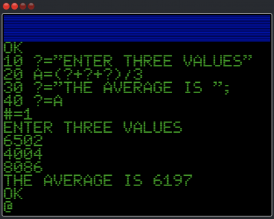

Thanks! I just tried the following (it's a bit simpler and it gives me more stack space):
bang     = $82      ; {!}  return line number
         [...etc...]
nulstk   = $007f    ; [Gigatron] v6502 stack in page 0
         [...snip...]
simple:
    asl             ; form simple variable address
    adc  #$40       ; [Gigatron] sp..'_' -> $80..$fe
    bne  oper8d     ; [Gigatron] (always taken)
With that it looks like we have a new interactive language on the Gigatron:
User program space is from $700 to $7ff, and the input buffer is 34 bytes. So not a whole lot yet. Both can be improved by rearranging screen memory. That wins a couple of KB, but that's something for after summer.
