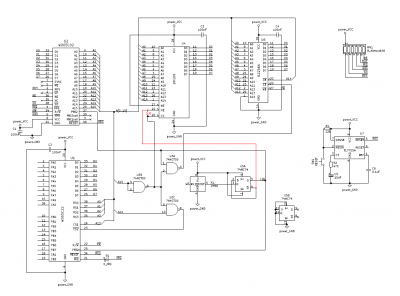

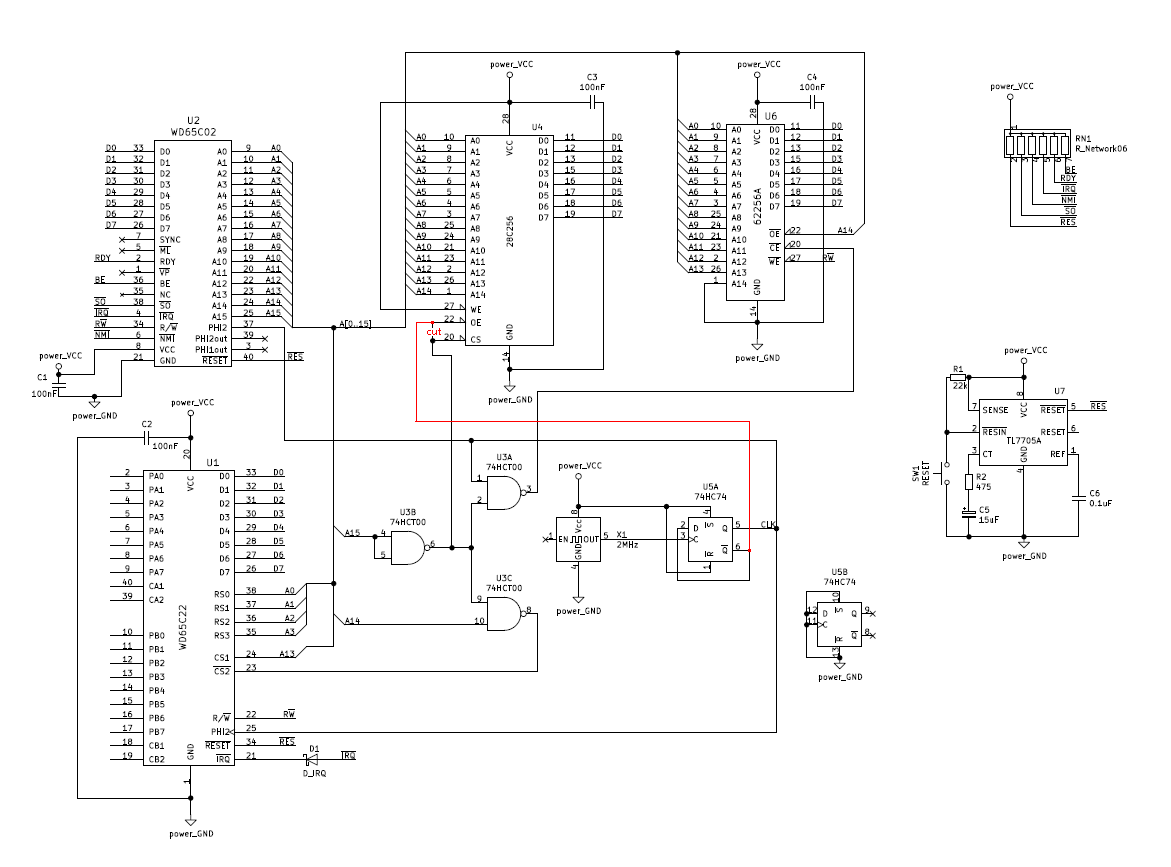

I'm going to take a stab in the dark (to borrow APL's phrase :) ) and suggest a slight wiring change. As an experiment, are you willing to try this, jgroth? Given that it's a breadboard, this should be pretty easy to do (and later easy to undo, if you like).
As shown in the diagram below, delete your original connection to /OE (pin 22) on the EEPROM. Instead, make a connection between EEPROM pin 22 and /Q (pin 6) of the 'HC74. All the other connections, on the EEPROM and elsewhere, remain as is.
If you're up for this, please give it a try (using the table-driven VIA init routine, of course). I'll explain my hunch later. The change may or may not have any effect on the problem, but it won't do any harm.

So /OE will go low a bit before /CS goes low as /Q will be shifted 180 degrees compared to the clock. Timing problems perhaps. I will definitely try that this evening (UK time).

Well, 6500 (and 6800) series processors use the Phi2-low time to prepare for a data transfer and the Phi2-high time to actually perform the transfer. Preparing for the transfer entails the propagation of a new address onto the address bus... and it also entails a potential change of "ownership" of the data bus. During write cycles the data bus is driven by the CPU, and during read cycles any of several other devices (RAM, ROM, I/O) may take their turn.
Getting the devices to start and stop driving the bus is a somewhat inexact science. One of the reasons is, the devices don't instantly respond to changes on their /CE and /OE inputs -- and, the delay can only be predicted approximately (the margin of error could easily be 10 or 20 ns -- or more). This implies a threat of short-lasting bus collisions (bus contention). For example, in a handover from Device A to Device B, there's a risk Device B may begin driving the bus before Device A has stopped -- and for 10 or 20 ns the computer's Gnd and Vcc network gets blasted with a large current spike. :!:
It's not unusual to see designs which ignore this issue (the collision is brief, and arguably may be considered tolerable). But the solution is simple. Just arrange your glue logic so no device drives the data bus during the Phi2-low time. This guarantees a big, fat 500 ns timing "cushion" -- enough to soak up any variability and ensure that every bus handover is courteous and gentle. :)
( I can't specifically explain how a large current spike might produce the symptom we're seeing here, and that's why my concern is only a hunch. But clearly we have a computer that's acting "funny" -- it seemingly executes some code correctly, and other code not. And "funny" behavior is often the result of noise issues such as those caused -- especially on breadboards -- by current spikes. )
I'll be interested to learn the result of the experiment!
