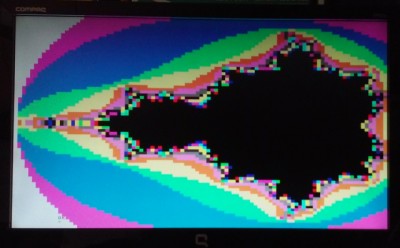

Thanks for the Mandelbrot code. I modified it to generate a 100x75 16-color version on my FPGA-based 6502 system

One thing to watch out for in BBC Basic is that screen coordinates are not necessarily pixels. So, depending on the actual screen resolution, the X and Y increments might be by 2 or 4 units rather than 1. Get this wrong, and it all looks fine but runs much slower than necessary.
