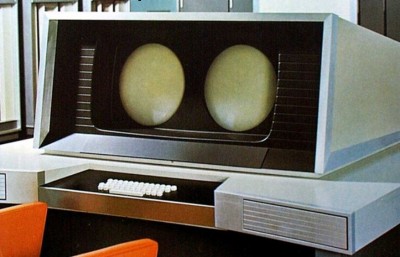

PostPosted: Tue Aug 18, 2020 6:32 pm
Posts: 1930
It reminds me of a CDC 6600 :-)
PostPosted: Tue Aug 18, 2020 6:34 pm
Posts: 632
Yeah, there is certainly resemblance there!
Maybe I had that in my mind along with the PET styling when I opened SolidWorks this morning.
SpaceWar is going to look great on my 360x230 NTSC display with 16k colors!
