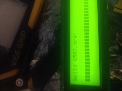

Definitely, unfortunately until I green wire the 521 I can't use garth's memory expansion. But for most of the initial programs I want to run on this, I think it will be more than capable. The ultimate goal is a full stand alone machine, so I'll need to see about picking up a DIN-5 keyboard at some point, or build one (I picked up a cable end for DIN-5 on one of my orders should I choose to do so, but I'm not sure how those keyboards are read from).
Anyway, I've got a special surprise in the works for this thread, just reading the datasheet on VIAs right now so I can execute it. I might not get it done until later though, as I'm thinking about taking a victory break, to celebrate the success of getting the machine stable. It's a lot to take in, seeing a full computer designed and built by me actually operate.

As promised. The surprise is here:
EDIT: sorry for rotation, and bad quality, my phone apparently didn't like my surprise
