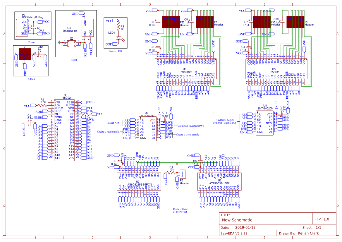

Recently I've started designing a PCB for my 65(C)02 project that I'm working on. I've never done anything of this type, so I want someone to check my design to make sure that it will work before I order the circuit board.
EasyEDA Link:
https://easyeda.com/kellanclark22/new-project2
Image:

Hi Kellan,
I think the way you generate RBWE as you call it isn't how it should be. You need /WE to go inactive when PHI2 becomes 0. So use one free NAND (U7) to invert RWB then NAND this with PHI2. This should work. Further: connect all unused gate inputs to either VCC or GND, even when you do not need the gate at all. They might oscillate otherwise.
There is one LS (U8) - HC or AHC is better.
ALL your VCC connections are wrong. I think you know what I mean.
There is no pullup provided for an open /WE for your EEPROM. If the jumper P5 isn't set /WE would float!
There are no pullups for NMIB and IRQB - and you may add a pullup for VPB.
Don't know if I had overlooked something. I didn't check the pinning of any device.
Have fun.

Thank you.
1. I NANDed the clock and RWB to get a read enable, then inverted that to get the write.
2. I now have all the unused gate inputs connected to ground.
3. That's now fixed.
4. I cant believe I messed that up. I think they're good now.
5. I've never used a pullup resistor, but I think that's fixed.
6. I don't think I need pullups for IRQB and NMIB because they are controlled directly by the 65C22s, and since I'm using a WDC 65C02 I don't need a pullup according to the primer

For future reference, when you post a schematic here, it's a good idea to post them in black and white. There are some people here who are colourblind, at least one of whom is very knowledgeable.

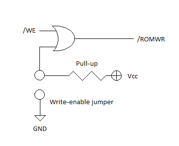

For the EEPROM write-enable jumper, I'd recommend using something like this(I use this in my own design):
Write-enable jumper.png (3.55 KiB) Viewed 1010 times
This will ensure that your EEPROMs /WE input is deasserted(high) when the jumper is removed, and when inserted, /WE will be asserted when /WR is.

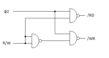

Your /RD and /WR generation isn't quite there. As it sits, you are generating /RD correctly(You've called it RWEB), but your /WR(RBWE) isn't correct, because it will be true whenever /RD is false, and that goes false when phase 2 is low. This will generate spurious writes(if those hit the EEPROM, your SBC will probably crash). I'd use a circuit like this, using gates from your 74HC00:
