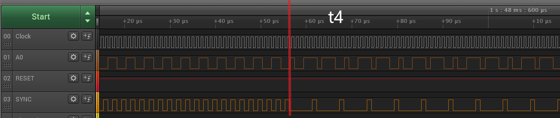

Well look at the behavior I got now. After the RESET, the A0 is down. Does SYNC give a pulse to search for the correct OPCode? I divided the image into 4 "moments" of time that I called t1, t2, t3 and t4. My doubts are:
Databus: $ EAEA
1) What actually happens in t2?
2) Apparently everything is correct at the right time t3?
3) It seemed all correct until t4. What could have happened?
Thank you!

PostPosted: Wed Dec 19, 2018 12:50 pm
Not at all. This is interesting.
T2 is normal: you see the sync pulse during T1, that's the machine doing a RESET by executing something which works like a BRK, a 7 cycle operation.
At T4 the machine seems to switch from 2-cycle instructions (like NOP) to a repeating pattern of 6 cycles. I'm not sure why it might switch, if the databus is hardwired. Could there be an interrupt? Have you tied off NMI and IRQ to low? (I'd be happier if the repeat was a 7 cycle repeat - perhaps it is, and I've miscounted.)
No. The data bus is turned on harwired with $ EA. NMI and IRQ are always high. So I do not know why he changes behavior without some change happening.
Anyway I will do all the tests possible. I'm finding that my breadboard is causing all these problems. :-(
PostPosted: Wed Dec 19, 2018 7:50 pm
This sort of thing is always a matter of deduction, and often about figuring out what assumption is wrong.
I see now that the post-T4 behaviour is a pair of 6 cycle instructions - probably the databus value has changed, somehow. If the breadboard construction is noisy or connections are unreliable then the circuit isn't even a constant. That would probably be my top hypothesis.
