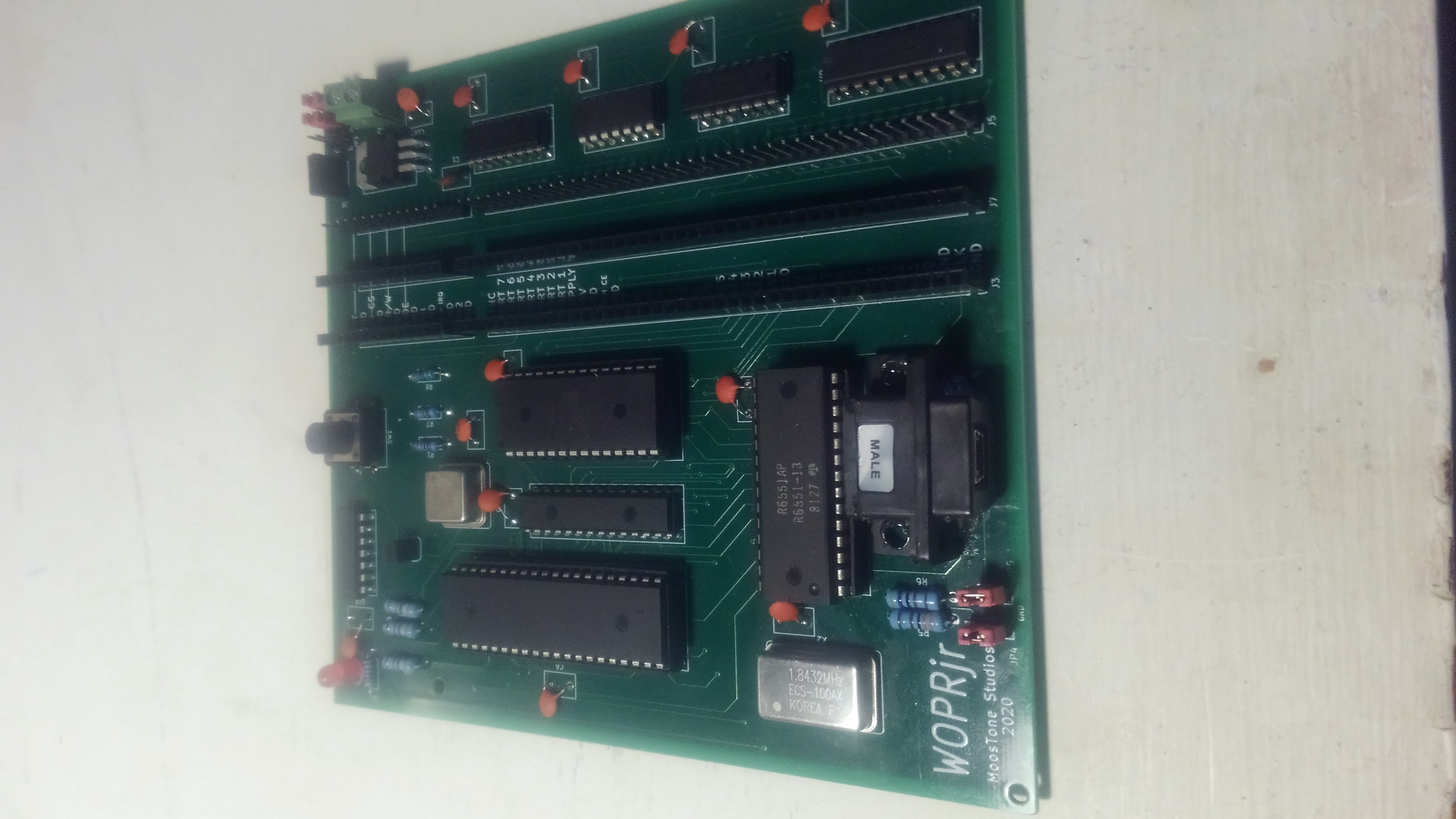

Been awhile since I posted an update, and a lot has been accomplished.
I'd say "stage one" of the project is complete. I'm off the breadboard finally. I had a 4 layer PCB from JLC made. Dedicated power and ground planes. Photo below. Computer runs well. Currently still at 1 MHz. One Rockwell 6551 UART is the only on board I/O.
I put two female and 1 male pin header expansion buss's on the board, so that I can develop the hardware for the next stage (on board video and keyboard support). The male pin header is for easy connection of my logic analyzer, and has been a great feature.
I finished writing the monitor program. If one were a glutton for punishment, one can now enter a program into memory with hex. I don't recommend it. The few short routines I did for testing purposes gave me a new respect for those of you that programmed Altairs and the like.
I have 90% of a home rolled VGA compatible text video card working. I have the sync signals, and character generator working. All 7400 logic (almost 30 chips, including the character ROM!) Couldn't find a ready made way to get character bitmaps in the format I needed, so I wrote a windows editor to create my own. Happy with the characters I was able to create. The bridge between the computer and the video card is still under development. Using a dual ported RAM chip. I've had it kinda working, but was getting unreliable results. Part of the decision to make a PCB for the computer itself was to try and eliminate a source of instability. Haven't messed with my video circuit yet since doing that.
Keyboard will be a PS/2 interface going into an Atmel microcontroller, and from there to a 6522.
Anyway, thanks for all your help! I'll keep posting progress!
