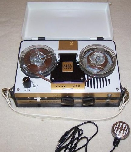

Posts: 8545
From this post (I had forgotten about it, but the page there is relevant to the tape discussion):
      I had worked as a repair tech at TEAC a few years earlier, and I aligned every machine when I was done with it. I was quite familiar with the poor performance of cassettes, which might not be what you'd expect. <snip>
      Also, at 0VU, cassettes' frequency response is terrible. It only goes to about 4kHz. You might look at the specs on your expensive home-entertainment cassette machine and see something like 16kHz; but that's always measured at extremely low levels, like -40VU, so as not to scare the prospective buyer away. <snip>
      Another problem for typical cassette data circuits is that at high frequencies, the phase is all over the place because of poor tape handling in the shell and not moving the tape fast enough for the amount of flexibility of the tape itself. If you play the left and right channels into the X and Y inputs of an oscilloscope and get a Lissajous pattern at high frequencies, what you'll see is like scribbling all over the center of the screen, because of the bad phase behavior and inconsistent output level. The poor phase response undoubtedly contributes to the error rate in the way some cassette data circuits were designed.
      OTOH, the open-reel machines gave solid, steady tones at 20kHz and 0VU. There was no need to hide the truth by manipulating the specs.
Open-reel does so much better because of thicker tape and better tape handling which make the tape's movement over the heads much smoother and more even, and of course does better in the frequency response, noise, and dropouts department because of higher tape speed and wider tracks. Now if you really wanted vintage, you could use one of those popular small, portable open-reel machines with 3" reels, like what showed up in the "Get Smart" TV series, being used to store data, even before the Compact Cassette came out! :lol: I have one I bought several years ago just for the historical value. It still works. It looks like this:
It was cheap and definitely not an example of good performance though, even for its time.
