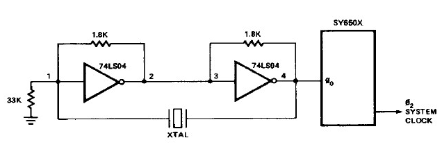

PostPosted: Fri Aug 24, 2018 6:25 pm
Joined: Mon Aug 20, 2018 4:04 pm
Posts: 7
Hi Friends !
I've attached the full CPU board scheme (fig.1). It was re-drawn by me, because the original one looked like a caveman painting.
In addition, I drawn the most exactly representations of digital waveforms presents in all I/Os of the R6502AP I'm using now. There are few address busses with no activity at all. BTW, the data busses pulses goes from 0 to 4v, and the address ones 0-5v.
All those pulses are absolute static, I mean, there are no dynamic activity (like data flowing) in any bus.
If I use the CMOS version, R65C02, or the original SY6502, there are no activity at all in address and data busses (except for 1Mhz in pin 39).
Years ago I've changed the sockets by mechanized-holes ones, the electrolytic caps and all TTL chips are news (and socketed, too). I've been suffering too much time with this machine, so I had time to make all this replacements.
The 5v rail is stable: 5.03v and no 50Hz ripley, just a very little noise of 1Mhz (10mV at most)
Do you think I would need to try with a most reliable crystal clock circuit, as it shown in the SY6502 datasheet (fig.2)
Thanks for your time !

PostPosted: Fri Aug 24, 2018 9:36 pm
Posts: 660
Location: North-Germany
Thank you for posting this schematic - great job! Your measure of the voltages does look very well, these values appears "normal" to me. I don't think that there is something broken.
There are some interesting (or strange) details in that schematic :)
I wonder why they have two reset circuitries - one for the CPU around IC24 and one for the VIA (IC12) using a 555 that can be triggered by a pushbutton? But I assume you have verified that both RESet signals start with "0" and the turn to "1" briefly past power on.
There is an alien signal called "F3". It is connected to the "/NMI" input (p6) of the CPU. It is necessary that this signal is "1" during the start procedure - if possible disconnect it until some more activity is achieved. There is R26 that pulls this line up to 5V. So just disconnect F3 from whatever there is attached.
The 60/40% duty cycle of PHI2 (CPU,p39) is not very well, perhaps you should use a different oscillator (a can osc. or that circuit you suggested) to achieve 50/50% somewhat better.
There is a battery (or accumulator) to pull up the /CS of each RAM. Again I assume you have checked this being working or replaced it already.
Replacing old sockets and electrolytic caps you have done already - good.
Have you a tool to read out the contents of the EPROMs ? IC21 should deliver at least the first two bytes (the so called RESET VECTOR) for the CPU, so it knows where the main program is located. The addresses are $FFFC (low part of the program start address) and $FFFD (high part). They are fetched from the EPROM immediately one after another. And then they are used to fetch the first instruction. This address should be somewhere in the range from $E000 up to $FFF8 as that is where the EPROMs are placed. Perhaps you can figure out what is going on during these first 10.. clocks after CPU /RES is "1".
