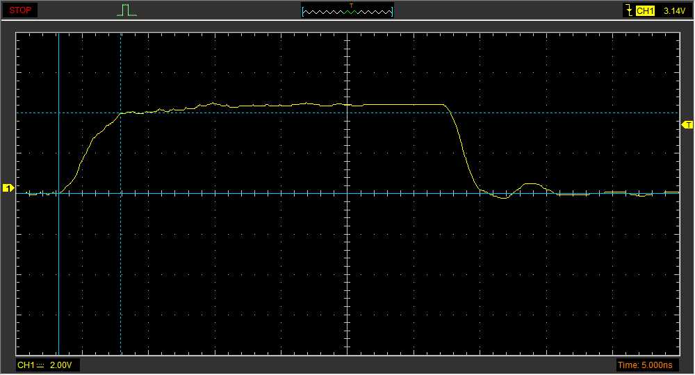

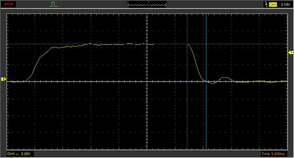

PostPosted: Sun Jul 08, 2018 1:55 pm
Posts: 1005
Oh, I don't doubt that at all. However, as Garth notes above, the current draw during an output's transition from low to high will be much greater than 20µA, which load will pull down the output voltage until parasitic capacitance has been sufficiently charged. That has the effect of rounding the edges and if sufficiently severe, provoking problems.
That is true, but it's not nearly as bad as you might think from looking at a spec sheet. The internal resistance of the output MOSFETs is not a constant over time. It is unfortunate, but manufacturer's spec sheets leave out what I consider to be very important information about the behavior of their devices. For instance the Voh characteristic we are talking about is a DC characteristic and not very revealing about the dynamic behavior.
The below traces are the /OE signal in my recent project at 16MHz. This signal drives both the RAM and the ROM /OE and the line, with chips inserted, and scope probe attached measures at 55pF and 257K ohms, both measurements taken at 10KHz. We can see the following:
1) Rise time (which is not very significant for a /OE signal) to 2.4V = 2.3ns
2) Rise time to 4.0V = 4.7ns
and, most significantly
3) Fall time from 4.46V to 0V is only 3.4ns
(not sure why the actual measurements don't get put in the trace image files - a bug in the scope software?)
1) and 2) demonstrate an important characteristic of MOSFETS. That once turned fully on, (~1ns in this case - see where the rising edge turns most vertical) they can and will pass significant current until thermal effects begin to take hold and increase their resistance. Using the formula Garth gave us, we can see the initial current (0V-2.4V) averages at ~57mA and that the average current to drive the line all the way to 4V is ~47mA. Considerably higher than the 3.2mA suggested by the data sheet of this Lattice GAL20V8C which, as usual, gives us less information than we really need to determine if a device will actually suit our needs.
3) Shows that in this rather typical situation, the GAL will indeed produce a valid CMOS Vih of 4.46V. Not only that, but it will assert the /OE signal from that 4.46V all the way to 0V in just 3.4ns - an average current sink of ~72mA.
Now, after having said all that, the scope probe itself adds a measured 16pF load to the line, so the actual performance will be better than depicted here.
1)
2)
3)
