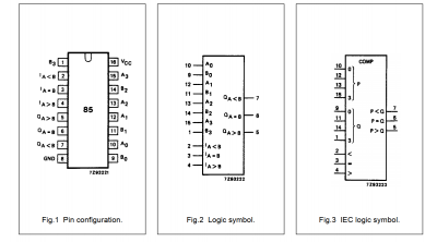

In short, in general treat chip-select lines as address logic, and wire address decoding logic to them; treat output-enables and write-enables as control logic, and wire clock-qualified control signals to them.
This is exactly what needs to be done. Use the /OE and /WE qualifier given from the schematic of BillO's post (near the top of the page):
BillO wrote:
Connect /WD to RAM /WE.
Connect /RD to both RAM and ROM /OE.
As your memory map requires only 3 select signals /CE_RAM, /CE_ROM, and /CE_IO you may use a 74HCT85.
74HCT85.pdf [69.99 KiB]
Downloaded 193 times
It is a 4 bit magnitude comparator.
If you setup the B inputs to $B while feeding A15..A12 to the A inputs and set inputs A<B, A>B to 0 (false), A=B to 1 (true) then the output signals of the comparator would match your address map - you only have to invert them to be low when valid. A<B would become true if A15..A12 are $0..$A => RAM. A=B is only true if A15..A12 = $B => IO. And if A15..A12 are $C..$F the output A>B is true => ROM.
It is pretty slow. I takes roughly 50 ns to do its job. This is no problem for RAM or ROM. But you have to verify what the requirements of your I/O device is. Many 65xx IOs require chip select to be valid a lengthy period before the rising of PHI2!
If you have slower RAMs and/or ROMs (e.g. 55 ns or 70 ns types) use them instead of the fast ones.
