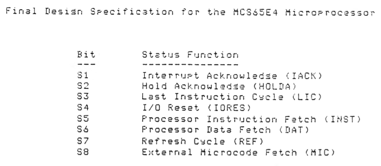

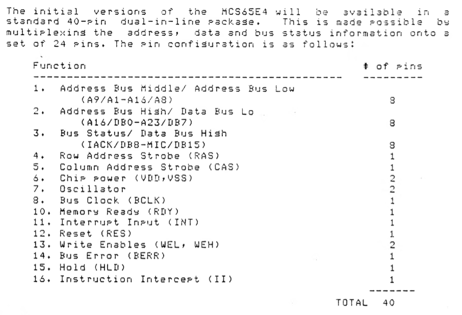

Mike has recently unearthed and published a remarkable document: a specification of an MOS chip called the 65E4, intended to be a powerful high level 32 bit MPU successor the 6502. Even, somehow, with backward compatibility for 6502 code. It's a big document - 182 pages! See a few snippets below.
I'll see if I can first describe it and then later make some observations. It's meant as a high-level device: multiple protected processes, good compiler target, CISC all the way. Oh, and registers? There aren't any programmer visible data registers - all operations are memory to memory. (The only visible registers are base and limit registers.)
Physically:
- 40 pin chip with 24 bit address bus and 16 bit data bus (some multiplexed pins!)
- Direct support for DRAM with RAS and CAS and refresh
Programming model:
- Flat 24 bit address space, each process operates between base and limit
- Support for 6 bit relative addressing and 9 bits of 'zero page' short addressing
- Support for three levels of privilege: Kernel, System, User
- Many possible traps/exceptions: stack growth, overflow, divide by zero, protection, type error
- Stack relative, program relative, heap relative addressing modes
- Programs relocatable in flight (logical addresses written to memory but physical addresses used within the MPU)
- All addresses subject to base and limit controls, positive offsets only from base
- Support for operating on bytes, double, triple byte values...
- ... also binary and decimal real formats, longer integers, and strings
- ... all using a descriptor byte ahead of the data instead of opcode bits
- ... also supporting records and multidimensional arrays
- ... which can be nested
- ... all of which can be relocatable
- ... and arrays can be bounds-checked
- ... and the descriptor byte can defer the data definition by giving the address of a further descriptor byte
- ... which can again defer the data definition...
Lower level details
- Instructions are bytesized opcodes with a trailing byte for addressing modes and more bytes for up to three operands
- Clocked at 8MHz for a 2MHz memory cycle
- 8-bit ALU with BCD capability (can perform 32 bit operations in one memory cycle)
- Machine is microcoded and nanocoded, both in ROM
- Multiple sets of microcode selectable for each process, somehow microcode can be fetched from memory perhaps?
Opcodes then operate on one or two operands from memory and store back to possibly a third location. Operations include all the usual logical and arithmetic ones, as well as multiply, divide, modulus, square root, leading zeroes, leading ones, find string within string, find one of several characters within string, evaluate RPN expression...
The traps and exceptions machinery is quite involved: we can trap on instruction executions, on data accesses, and we can trap mid-way through instructions. A lot of chip state is pushed to stack (60 bytes!) which seems likely to make interrupt latency quite high. On the other hand, the bus interface supports DMA and coprocessors so perhaps other hardware is expected to be doing more work autonomously.
What are my thoughts on this... well, we have some very complex instructions, we have no visible register file, we have variable length instructions, we have instructions which take very many clocks. There are counterarguments to RISC, and this machine is perhaps embracing them, although that debate wasn't quite open at this time. With complex instructions, you need fewer instructions to do a task, and the instructions can match the operations needed by high level languages. With the base and limit checking, the exceptions, the type checking, perhaps programs are safer on this machine than on a C-like machine.
The implementation is in some ways modest: 16 bit wide memory path, 2MHz memory cycle, perhaps somewhat tied to DRAM sizes of the day, sticking to the 40pin DIP.
But the architecture is very ambitious - does it perhaps nail down too much by way of what a compiler must look like, and what an operating system must look like? Is it perhaps too complex to explain and so too complex to sell, too complex to debug, too complex to be convincing that the chip will ever appear in a working state?

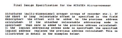

I can reformat the document. Would it be better to keep the text paragraphs right-justified (and 100% consistent with the original), or to let the right justification drift in order to have consistent spacing between words?
PostPosted: Wed Jun 27, 2018 8:42 pm
Posts: 1004
I just want it legible, spacing is a bonus! Fully justified is fine by me, but I'm not picky.
I mean, I'm seeing what everyone else is seeing, right? Most of the pages look like they were double struck by a slightly out of alignment typewriter.
PostPosted: Wed Jun 27, 2018 8:49 pm
Posts: 10800
Hmm for me it doesn't look doublestruck, rather it looks a bit faint.
PostPosted: Wed Jun 27, 2018 9:12 pm
Posts: 672
It looks like the OCR text is being overlaid on the scanned text in your image, whartung. Probably a bug in your viewer.
PostPosted: Wed Jun 27, 2018 9:31 pm
Posts: 1929
It looks like this for me in Chrome. My Epson MX-80 did a better job than that, but I have also seen far worse.

It is surprising and a bit disappointing that so much of the discussion here has been about the quality rather than the contents of the document itself. I found it to be quite an interesting read. It's possible that scanning it again with different settings might help a little, but I doubt it would produce a significantly better result. The paper version was an obvious photocopy and not great quality. I'm grateful the document survived at all.
PostPosted: Wed Jun 27, 2018 10:34 pm
Posts: 8433
Agreed. The print quality is typical of so many documents from back then; and especially since the processor was never made and sold, it's not surprising that they didn't go to the effort to get it typeset. Today of course everyone has desktop-publishing software and laser printers; but that wasn't the case back then. I've added it to my links on my links page. Thanks, Mike.
