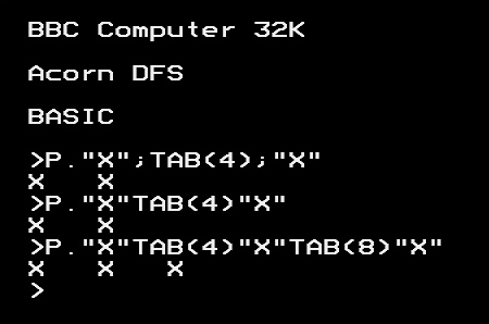

Yeah, SPC(Z) isn't the correct choice for this case. The TAB(Z) I know is supposed to keep track of the current output column position P and try to space to the requested column Z, but only if it's to the right of the current one. It'll output (Z-P) spaces, but no "negative" spaces.

Here's a snapshot of the Beeb's output for
PRINT "X"TAB(4)"X"TAB(8)"X"
- you'll see the Xs are evenly spaced (and there are only three spaces printed between each pair)

AppleSoft:
Hmm ... it looks like TAB() treats the leftmost column as column 1, and POS() treats it as column 0.
Mike B.
 Post subject: Re: A test program?
PostPosted: Tue Jun 19, 2018 8:42 pm
Posts: 10802
So SPC(Z-POS(0)) instead of TAB(Z) should do the trick?
edit: in BBC Basic, you'd use POS instead of POS(0)
PostPosted: Tue Jun 19, 2018 8:47 pm
Posts: 1930
That or SPC(Z-POS(0)-1) with a risk of crashing if the argument winds up negative.
