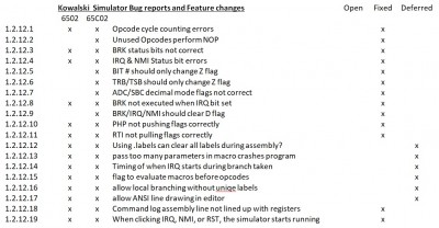

I have been working on fixing bugs and adding features to the simulator. I am pleased to release v1.2.13 for everyone to use. Please let me know if you have any issues with this release.

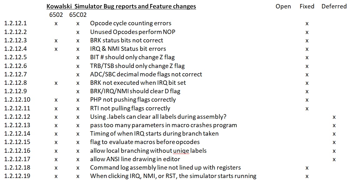

Here is a summary of the issues I have collected and their current status:
It has passed both of Klaus' test suites - the 6502 and the 65C02. I has also passed the timing test that BigEd created (details here -> viewtopic.php?f=8&t=3340&p=38584&hilit=kowalski#p38581 )

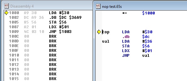

For those interested, unused opcodes in 65C02 mode will be executed as NOP's using the appropriate operand modes. You can use them by using the .DB or .BYTE pseudo opcodes. Here's an example of using the undefined opcode $DB, which has an "absolute" addressing mode.
You can see in the disassembly window that the LDA #$36 at $1003 gets absorbed into $DB's operand. This trick allows you to call either top or val to load different values into address $56, in this example.
As a side note, the yellow pointer will not display on lines that do not contain valid opcodes in the source windows, but you can follow the pointer in the disassembly window. This is on my list to try to fix in the next revision.
The disassembly window will also jump when you move to address $1003 so that you will see the LDA #$36.
The command log will show the correct opcodes, similar to the disassembly window.
I hope everyone finds this useful, or at least understandable.
