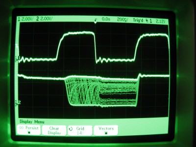

Posts: 352
Just to note, in some experiments with Dave aka hoglet, we found a case where a CMOS 6502 in an Acorn BBC Micro would almost work, and the failure was very specific:
So we have 18 fails which are all from SBC immediate of a small negative number, and which should have cleared the carry but failed to.
I'm pretty sure we decided this was some kind of internal timing problem, and fairly sure that tweaking or slugging the clock fixed it. I'll ping Dave, as his recollection will be better. (I think we decided that the operand coming from RAM was arriving just too late relative to the clock, so it was an external timing violation with a very specific internal effect.)
Yes, this was when changing the processor in a BBC Model B from an NMOS SY6502A to a CMOS R65C02P2 (both genuine!)
There was a thread over on Stardot about this:
http://www.stardot.org.uk/forums/viewto ... =3&t=14465
This post is showing the likely cause:
http://www.stardot.org.uk/forums/viewto ... 46#p193146
In summary, the RAM read timing on the BBC Micro is very marginal, and changing to a R65C02 makes this worse by about 10ns. This is seen by the 6502 as a hold time violation, and it most affects the longest path, which is through the ALU and into the carry flag. What we were observing in the Dormann tests was the carry flag failing to update correctly.
This related thread was also quite interesting. On an Acorn Atom the 60Hz VSYNC signal is asynchronous to the 6502 clock. It's possible to write a program that will fail after maybe an hour due to metastability propagating through the 8255 and on to the 6502.
http://www.stardot.org.uk/forums/viewto ... 9&p=200632
Dave
