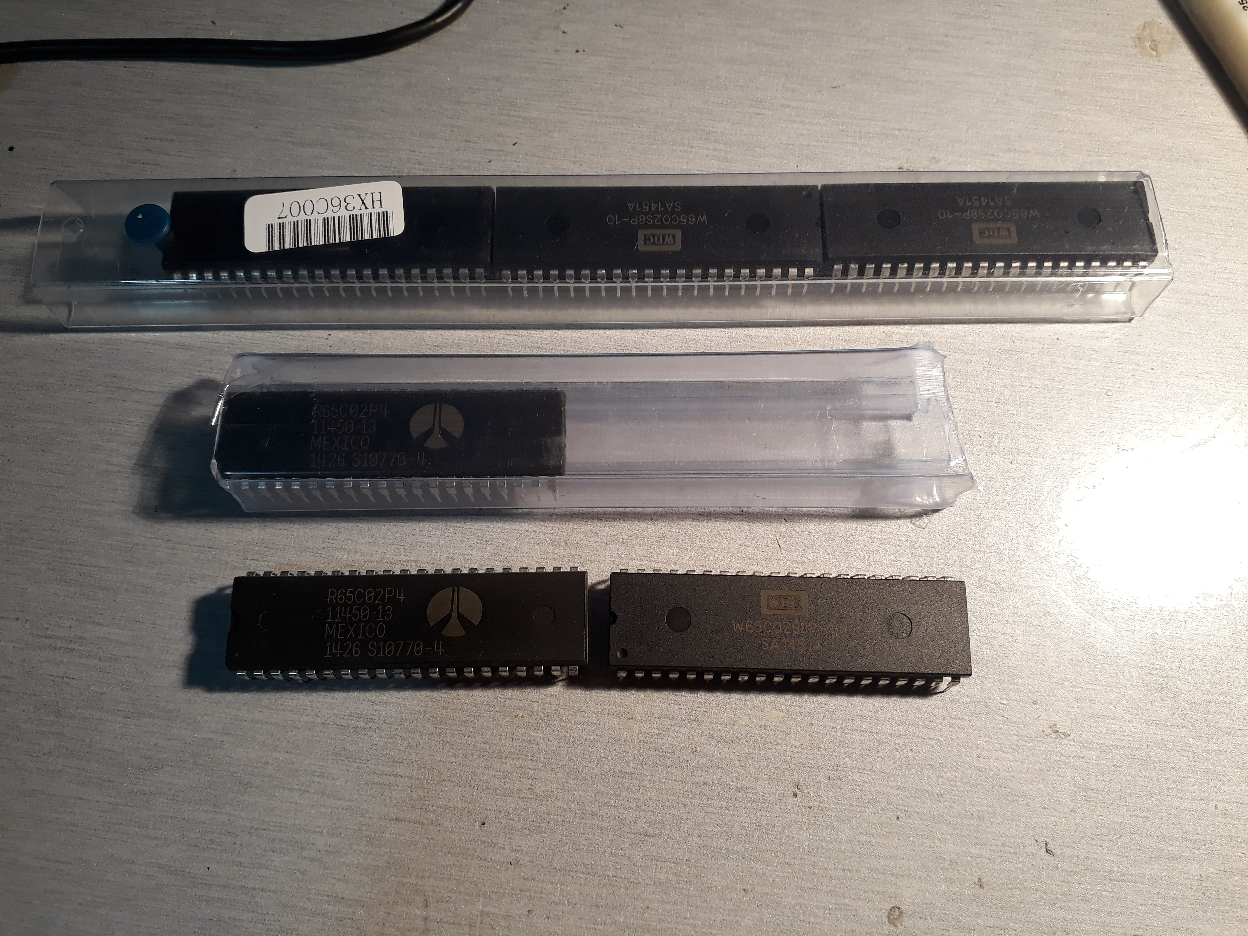

Well, this is my first post, so hello everybody.
I've wanted for a very long time to build my own tiny computer from scratch, and after a friend told me he was doing one himself, I began actually designing mine.
My idea was a 6502-based design, at the highest speed I could run it reliably, so I went with 10MHz W65C02. Because of the über-expensive shipping options of Mouser to Europe (my usual provider being RS-Components, but they don't stock WDC parts), I gave Chinese providers from eBay a go.
After unpacking it I noticed that the top of them were slightly darker than the bottom, meaning they could be well "blacktopped" chips (aka removed from boards, had the original laser-etched part number removed and re-labeled as a different one)
With a multimeter I tried measuring continuity between pin 1 (VPB on real WDC, ground on any other 6502) and pin 21 (ground), and indeed got continuity, meaning that they are a completely different IC, or another true 6502 but relabeled as W65C02.
I thus got an Arduino, clocked it manually while probing on key pins (data, A15, A2~A0, R/W, SYNC), and found something really odd.
I ran a very simple program, consisting of a RESET vector set to 0x0000, and a BRA -1 ("while (true);" loop) at 0x0000, and everything else set to NOP (EA):

As you can see, this CPU clearly doesn't support the BRA, so I thought "hey, this gotta be a NMOS MOS 6502 part".
But, here's the odd part: in the official 6502 during boot the stack writes that are part of any interruption (PC and processor status) are gated into reads. However they are not in this CPU. I have five of these fake 6502, and can say for sure they all behave the same, so it's not a one-off defect.
Any idea what kind of part do I have here? Could this be a 6502-compatible CPU designed from scratch by another manufacturer?

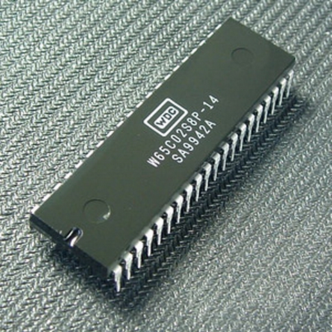

To my knowledge, WDC has not marketed 10 MHz 65C02s since the early 1990s, which means either yours is a pull (definitely not NOS, judging by the appearance) or a counterfeit—the date code says 2014, which is very suspicious, as you will soon see.
In either 1991 or 1992 (don't recall which), WDC converted the 65C02 (and the 65C816) to a fully static core and their foundry began producing the device in a smaller 0.8µ geometry—the S8 designator in the part number tells you this. Coincident with the geometry change to 0.8µ, the clock speed rating was increased to 14 MHz at 5 volts and slower speed grades were discontinued. To my knowledge, there were no 10 MHz MPUs produced in 0.8µ geometry, despite what the part number on the items you have says. WDC currently has their foundry producing their microprocessors in 0.6µ geometry, the switch to the smaller geometry having taken place a number of years ago. Therefore, an 0.8µ geometry part with a 2014 date code is an impossibility.
Given all this, I am very suspicious of the parts you received, which do appear to have been defaced in some fashion. See below for what a genuine 14 MHz WDC 65C02 looks like—the photo is straight from WDC themselves. Take careful note of the shape and appearance of the WDC logo and compare it to the logo on the microprocessors you have. The differences in logo appearance are what make me think your parts are not genuine.

I can positively tell you that the 65C02 in your photo is definitely not a WDC product. The date code 1451 indicates the device was manufactured during the 51st week of 2014. That is impossible, as WDC transitioned to 0.6µ geometry nearly a decade ago, which would be indicated by the presence of S6 in the part number of current production. S8 in the part number on your device is the older 0.8µ process that WDC adopted about 26 years ago when the conversion was made to static code. The 0.8µ process was discontinued around 2010. My information indicates that all 0.8µ devices were rated for 14 MHz—none rated for anything slower.
BTW, the topic of counterfeit 65C02s came up before.

Yes yes, I am aware that this is certainly not a WDC product. I am at this point just interested for sake of science in guessing which CPUs I had here.
The resistance between GND on pin 21 and pin 1 is in the order of 10 ohms, so I am pretty sure they are tied together, which would be the case if it's indeed a G65SC12.
Regarding the other fake Rockwell, I got a few fake of them from eBay as well when trying to source for an unrelated project. I have not done any testing with them yet.
EDIT: according to the G65SC12 datasheet, the pin 5 is VSS, but it doesn't seem to be connected at all on this chip: resistance to any power pin is over the 20Mohm my meter can read, vs about 700k for other inputs and outputs.
I'm guessing this could be a G65SC02, whose pin 5 is NC, and that those share the same CPU design and do write to stack on reset as well?

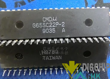

Well, thank you everyone. I've just found a picture of the underside of a CMD G65SCxxx chip and can say for sure these are CMD chips.
The circles on the top are exactly the same in the CMD chips I've seen. The notch on the top, and the circle marking pin 1 are also identic on mine
On the underside, they also use the same font and serial number format that mine have.
Again, thank you everybody.
