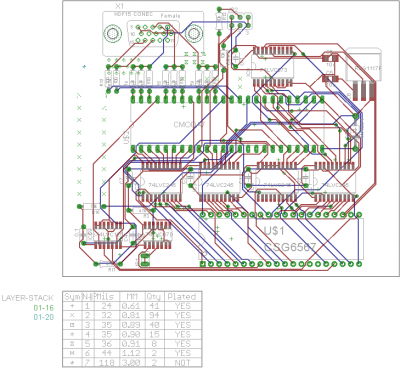

Updated schematics and board layout for FAL6567. Added a latch on the address bits which ultimately allows 9 bit color instead of 6 bit.
Placed the resistor dac right next to the module to reduce emi.
File comment: Schematic for FAL6567
File comment: Board layout FAL6567
http://www.finitron.ca

I created another version of the board that uses an ADV476 color palette for the dac output. The reason to use the palette is it requires fewer pins from the cmoda7. A second reason is it allows more accurate color rendition. A four-bit color code can be fed to the dac rather than using nine pins. It ends up saving three pins as a clock and blanking signal are needed in addition to the color code. The three pins could be put to use to generate a composite output signal for at least monochrome output. It’s somewhat dubious to use the ADV476 as it’s an obsolete part.
One thing I’m not sure about is if the two four bit dacs for used for generating sync, luminance and color components will work. The color output is open source on the VIC-II and recommended there be 1k to ground. So on the assumption that that output has a 1k resistor attached to it I made the dac so that the voltage at the output is approximately 1v at maximum output. According to the C64 schematic there is a pot available to adjust this a little bit.
The other output for sync+lum is open drain with a recommended 500 ohms to +5v. So I adjusted the dac resistors to have this output at about 1v again.
I seem to remember reading somewhere signal measurements in the range 0.0 to 1.0V.

I had to adjust FAL6567’s base clock frequency slightly from 33.750MHz to 32.727MHz. The MMCM (clock pll) can only multiply by up to 64 and I thought it could go up to at least 128 so I had it set at an illegal value of 66. 1 clock cycle was trimmed off all the timing shift registers. This may cause a problem of the ras high time (90ns instead of 120ns) being too short in the case of extra sprites mode. This shouldn’t affect the default operation.
The 32.727MHz is exactly 32 times the phi02 clock rate and exactly 4x the 8.1818MHz dot clock rate. There is also an exact divide for the color burst frequency of 3.58MHz.
