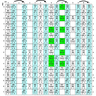

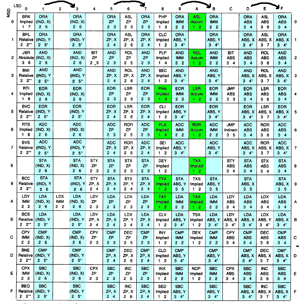

According to one line of reasoning (BigEd could provide the references for this) the 6502 was originally intended to have two accumulators. But they found this would've resulted in too large (and hence too expensive) a chip. So a brutally ruthless decision was made. The chip got very rudely downsized quite late in its development -- leaving some gaping holes in the opcode map.
That's an interesting theory I've never heard before. Ed, can you provide references for this? :)
PostPosted: Thu Feb 01, 2018 4:20 pm
Posts: 1948
By my rough count, there are about 75 opcodes in the NMOS map which use register A as a source, implied source, or destination. This seems to imply that it is at least plausible (if not practical) that a full-featured register B could have been added to the NMOS map ... and maybe even a tiny bit of room would have been left over for a few 'c02 enhancements like BRA, PHX, PLY, STZ ...
Maybe it would have been more practical to just add a simple XBA instruction ... lots of bang for the buck there ...
Mike B.
PostPosted: Thu Feb 01, 2018 7:51 pm
Posts: 10938
I'd forgotten the reference which Jeff picked up, about the two accumulators, but with a little prompting I've found it, and quoted with permission over here:
viewtopic.php?p=58458#p58458
PostPosted: Thu Feb 01, 2018 8:28 pm
Posts: 674
I wonder if their 2-accumulator design had "A = A op B" style instructions. If not, then yeah a XBA would cover plenty. (And you might as well go for XAC, XAD, XAH, XAL ... ;) )
PostPosted: Thu Feb 01, 2018 9:56 pm
Maybe, but that's a different theory than the one posed by Segher Boessenkool. "My strong suspicion is that originally the 6500 had *two* accumulators, and the instructions with low bits 11 were like those that now have 01, but for reg B instead of reg A."
Yup. And yup. :)
PostPosted: Fri Feb 02, 2018 4:23 am
For my own interest I started marking up the NMOS opcode map to get a sense of this. And I might as well share the result for any others who are also interested.
All the instructions in the "low bits 01" columns involve accumulator A (and I copied these into the "low bits11" columns). But a few instructions involving A are not in these columns. I marked these using a different color. It's not obvious what the corresponding B Accumulator opcodes would be, but things may've gotten juggled after the B Accumulator was deleted. Segher's theory remains plausible, I'd say.
