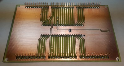

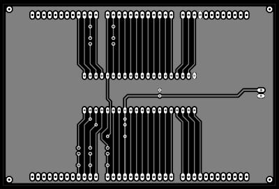

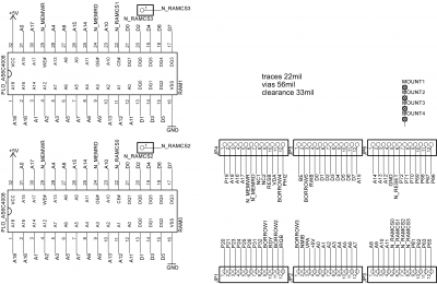

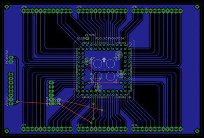

For about 65% of the above mentioned devices / modules I have finished the schematics and PCB layouts, these include the CPU-, CPLD-, RAM-, ROM- and DUART-board. These will be stackable and the basic design for MARC-3 S.
I bought a bunch of 12-pin Arduino headers and 120 x 80 mm single sided copper clads: the build can begin!
Next I’m going to present the CPU-board.
