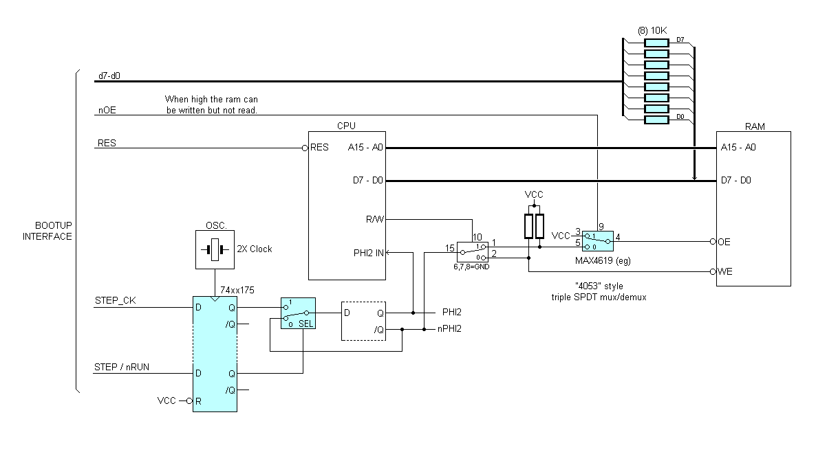

For me E is a "free" one-bit output port. Yes there's the non-trivial encumbrance of having to enter and leave Emulation Mode in order to turn it on and off! :P But sometimes that's acceptable. Here's an example.
In a few posts in another thread I describe a "blind loader" technique for loading the RAM of a ROM-less computer under control of a microcontroller or remote host system. Usually the final step is to let fly and run the code, using the STEP / nRUN signal to switch from single-step to free-run mode. And one design option is for that signal to originate from E, thus reducing the number of connections from the microcontroller or remote host. (This bootup scheme also allows single-stepped code execution, including that which'd perform a one-time exit from Emulation Mode -- the default following reset.)

Dr Jefyll,
What are you using the pullups for on the data bus in your schematic? Is the microcontroller going through them? Do you Z state them when the CPU is running?
 Post subject: Re: 65816 E, MX pins
PostPosted: Sat Jan 27, 2018 10:08 pm
Druzyek wrote:
Dr Jefyll,
Hi, Druzyek. I posted my reply in the original thread -- thought it made more sense to put it there. Cheers! viewtopic.php?p=58408#p58408
