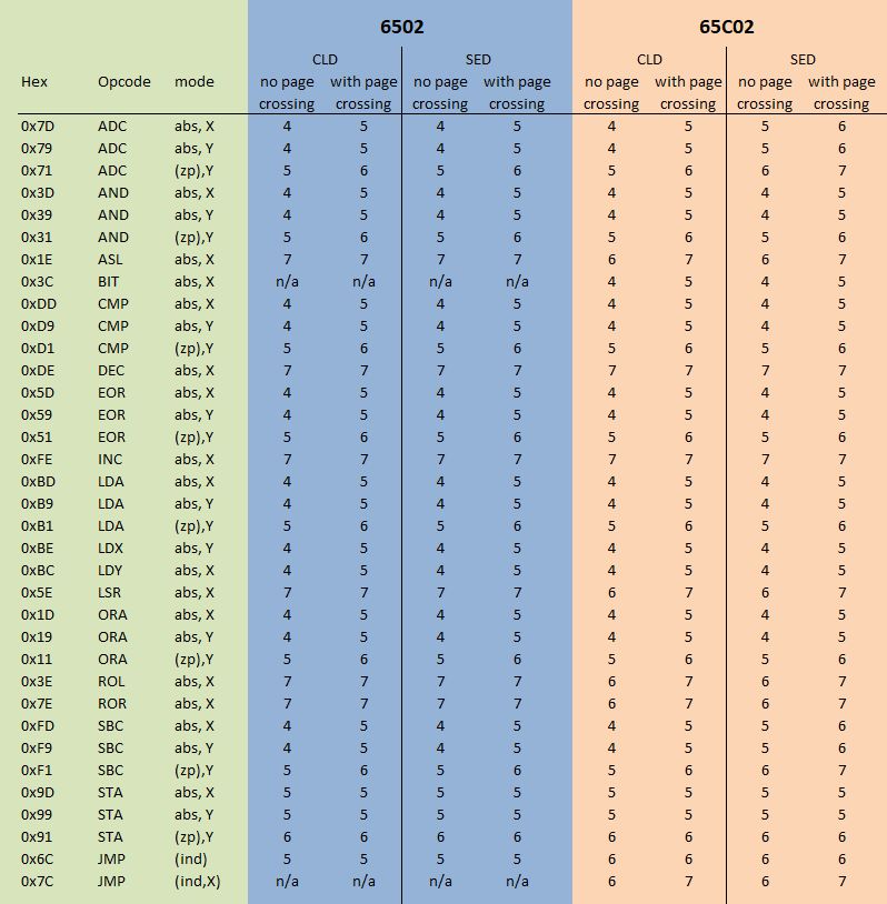

Here is a chart of the resulting timing of the instructions that cross page boundaries and/or are affected by the decimal flag
For what it's worth, JMP (ind) and JMP (ind,X) also involve possible crossing of page boundaries.
This is wonderful work you're doing, Daryl. Thank you! :)

On the 6502, JMP (ind) appears to use 5 cycles and does not cross a page, it wraps back to the first byte of the same page. On the 65C02, it takes 6 cycles and will go to the next page. I found no references to additional cycles being needed as they all use 6 vs. 5.
The JMP (inx,x) is only a 65C02 instruction, and takes 6 cycles. The WDC manual does mention add 1 cycle for page crossing, but the 65C02 tutorial on this website does not mention it. I will add this unless someone else can prove otherwise.
As for unused 65c02 opcodes. The Simulator treats them all as an illegal opcode and stops the simulator.
For the 65C02, I could add support for the cycles and bytes used treat them as a NOP code. If I do that, I should consider adding an option to select how they are treated. I don't want to venture down the 6502 road though... I'll just let the sim stop.

From Jeff's previous comments, I have added references to the indirect JMP opcodes and corrected the cycle counting. updated files are attached.
Thanks Jeff!!!

I've just looked at the Dormann 65C02 tests running with the 6502 bus protocol decoder, and I don't think page crossing adds an extra cycle to JMP (IND,X) (opcode 0x7C). It seems to take 6 cycles regardless.

The addresses are slightly different between the processors because they were running different variants of the Dormann 65C02 tests.

It really sucks having so much disparity on the documentation. Ok, the JMP (inx,x) will get changed back to 6 with and without page crossing.
