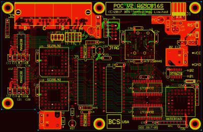

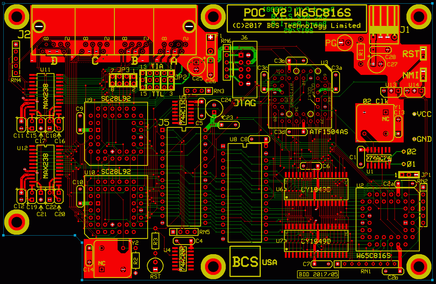

On my POC units, the bypass capacitor is placed as closely as possible to Vcc on the device being bypassed. The Vcc pin on the device is connected to the corresponding pin on the capacitor and the capacitor is what makes the connection to the internal power plane. This arrangement is based upon Dr. Howard Johnson's and others' recommendations and is one I have used for years. The other side of the capacitor is connected to the ground plane, as is the ground pin of the device.
The attached illustration of POC V2.1's four-layer PCB shows this layout arrangement—look at C8 and U8 (center) for an example.
File comment: POC V2.1 PCB
