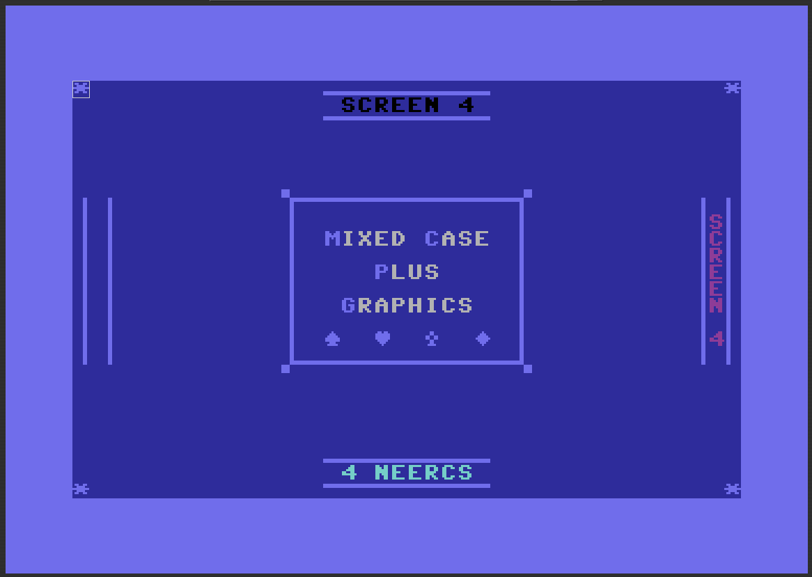

Cray Ze, to you it's obvious what you are doing there, but for us I think it isn't.
Would be awfully nice if you could just add a little bit of text to this screenshot.
Hmm... when looking at that screenshot...
If one would have a character set with all characters rotated by 90 deg.,
and if one would build the ROW and COLUMN counters etc. a bit different to make them run a different video address sequence,
I think it might be possible to display an entire text screen rotated by 90 deg., that's 40 lines of text, 25 characters per line.
Might be fun when writing code in assembly on such a screen...
after manually turning your TV set by 90 deg., that is.
Sprites won't be displayed rotated, of course.

But a good mystery sets the imagination to work. Mystery pause over, of course I'll elaborate a bit on what's going on.
I implemented many of the ideas mentioned previously in the thread, just not in TTL.
......you are seeing:
A 40x25 window into an 80x50 memory space/screen. The 40x25 can scroll about the 80x50 but in this case it's at the bottom right extent,
this is entirely because the data in my 80x50 screen memory consists of the spicing of four screens created in an online (40x25) PETSCII editor.
Along with the 80x50 screen memory, there is a matching 80x50 attribute memory. The character set is obtained from an image of the standard
C64 character generator ROM, there are no redefined chars. All attributes are applied on the fly.
I implemented XFLIP, YFLIP, ROTATE RIGHT 90, UPPER/LOWER CASE attributes. I hadn't gotten around to INVERSE text before putting the design
down for a while, but it's easy, the hardware cursor already uses the principle.
Rotation is easy enough but requires a lot of memory access, though the whole design runs the high memory access rate so at least nothing special
has to be done for a rotate. A pixel is a single bit, so if you're accessing ram at the pixel clock frequency, you're only ever interested in a single pixel.
Just exchange the vertical and horizontal counter bits used in the character decode and there is your rotation, on the fly, we don't care about the other
bits in the addressed byte.

Here is the same screen in the PETSCII editor, before exporting and splicing.
Colour translates nicely to attributes, except for when it's the same as the screen colour.
I had to massage the attribute output before using it as I'd used the wrong colours, search and replace in a text editor did the trick.

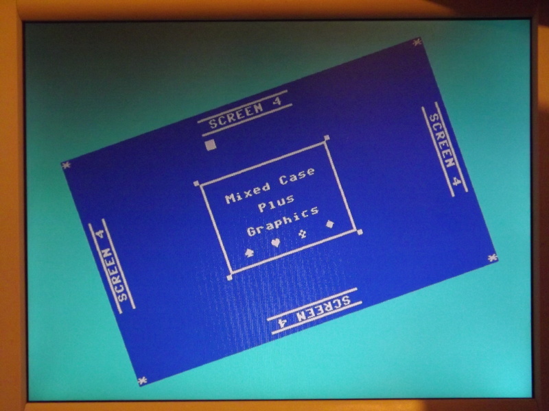

The idea is to increase the X and Y pixel counters to somewhere between 19 and 24 bits, and map the 80x50 onto a giant rotoplane that shinks the resolution back down to a 40 x 25 window
into an 80 x 50 addressable space, the expansion of bits in X and Y will give me the subpixel rotation and scaling I want. Sounds fine in theory.....

I fixed the timing so the glitches in the background of the lizard pics are gone. Locking the boarder to the rotoplane on the 40x25
window gives an interesting effect. I recall various flight sims and racing games that would shake the screen about when you crashed,
well, now the screen could be bounced about like a ping-pong ball, rotated, zoomed in/out or whatever. :)
Oh what a twisted path these pixels weave!

Hmm... so I guess it's about more memory bandwidth... and about using parameters with a fractional part or such.
BTW: In TTL terms, multiplication could be done with a lookup table in a ROM.
For instance, an 8*8 Bit multiplication then would take 64kWords of ROM...
but there is a neat mathematical trick that would reduce the lookup table to 512 Words of ROM.
Rotating a screen like that sure would be useful for a flight simulator... can you do this with sprites, too ?
It's running at the pixel clock now to gain the up-sampling, but could still run at the half pixel rate, resulting in no up-sampling and the same bandwidth as before.
Yes, calculating the correct parameters requires multiplying by a sin/cos lookup table. The roto unit can also stretch X or Y and I'm pretty sure it can flip/mirror as well
so it's probably best to leave the programmer to decide the function. I'd leave the option for raw control even if adding the multiply function to the hardware.
While not quite as fast, an 8*8 Bit multiplication can be done with four reads of a 256 Byte lookup table and three adds, quite easily done in CPU land.
Yes, you could have rotating/stretching/scaling/mirroring sprites :)
