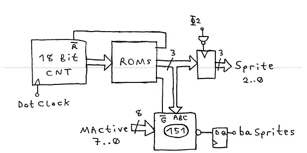

PostPosted: Mon Oct 09, 2017 6:31 am
Posts: 1392
If we would be building the BA logic for the sprites like in FPGA64,
this probably would take one page of schematic with conventional TTL chips.
The interesting question here is:
If we would generate the Sprite2..0 signals one PHI cycle ahead with the EPROM,
would it be possible to generate the BA signals for the sprites with
a 74151 8:1 multiplexer by tapping into the sprite enable Bits ?
For the rest of the circuitry, we would have to delay Sprite2..0
by one PHI cycle, of course.

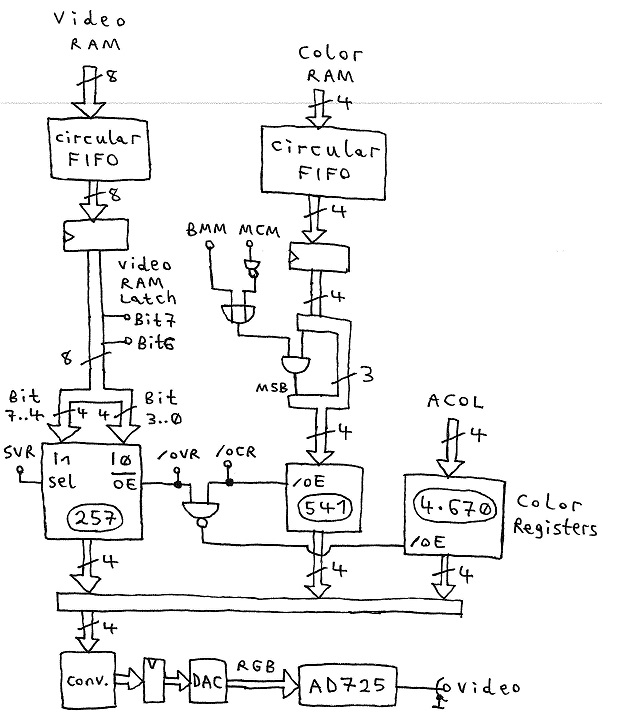

VIC-II has 5 valid display modes
(and 3 invalid display modes in which the screen is supposed to be blank).
Tried to do sort of some flow diagrams about what to do with the pixel data
at the output of the video shift registers.
BTW: "visible" in those flow diagrams means the pixel isn't inside the border
(and the pixel isn't inside the retrace blanking periods).

The circuitry that converts parallel video data to serial 4 Bit pixel color data.
Schematics are just provided as a concept of what to do with the data,
nothing more, nothing less. And it all probably contains some errors...
Notation looks a bit odd... mainly because I did this stuff in 2016,
before trying to dig into FPGA64, I just found the time to clean them
schematics up a little bit...
Note that 74670 'color register' block starting at $D020 in memory,
first color register would be Register32 of the VIC-II.
(One probably won't be building it by using 74670, but... well...).
Also note that 4 Bit address bus labeled ACOL3..0 for selecting the color register.
The block labeled 'Conv.' "somehow" converts the 4 Bit color data to digital RGB,
could be a ROM, a palette RAM, or both.

The bad thing when trying to implement the video data shift registers is,
that they shift one Bit per clock cycle when there is no multi_color,
but two Bits at every second clock cycle when there is multi_color.
An approach "according to the school books" would tend to result in quite some circuitry,
the circuitry probably would look a bit ugly, and it won't be too fast.
Inspired by the Air inlets of the SR-71, I decided to tinker with a concept
that pre_formats the 8 Bit data stream from the external data bus by using
two 74157 multiplexers into a 16 Bit bus, feeding two 74166 shift registers
(labeled H and L for a reason I don't exactly remember now) for shifting
the 8 Bit data.
IMHO this simplifies the circuitry fed by the shift registers a lot.
I'm not sure, if that AND gate for data\sprite collision detection
is placed correctly there, you better check.
/SGOT are signals from the 8 sprites, indicating that the sprite got display priority.
That 74257 feeding ACOL3..0 just increments a 2 Bit value by 1.
(74283 probably would have been slower... and without output enable.)
