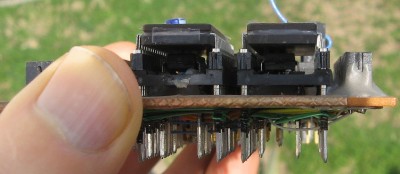

As for room, you can put other ICs under the VIA:
ICs under ICs are slightly visible in this photo also:
But really, for the amount of work you're going to put into it, the price of a second VIA is peanuts. Using the LCD in its 4-bit interface is easy, and probably won't be any less efficient than trying to manage it through other parallel logic which may slow your maximum clock speed down anyway, and certainly won't be as slow as doing it through SPI if you have to bit-bang it (although I do like SPI, even bit-banged!). Michael's idea using the '595 could be pulled off with the VIA's serial port, shifting at half the phase-2 rate without the processor having to bit-bang. In fact, I've done the following to get well over a hundred output bits from the VIA's SR (shift register):
