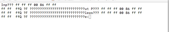

I have used this long delay to see whats going on.
My terminal writes garbage:

Almost.
The way you wait for an input is not to read the input buffer.
I thought that was clear before.
You read the status register. When bit 3 is a one, that means
there is something there to read. Then you read the input data.
the buffer doesn't clear because you read it. The status bit
does clear when you read it when you read the input buffer.
I also prefer to always use 2 stop bits. Some com programs
don't work well at updating the screen if you use one stop bit.
You might find you loops easier to calculate if you do:
LDY #$11
LDX #0
L0:
  L1:
    DEX
  BNE L1
DEY
BNE L0
This is because the first inner loop, you only loop 255 times while
the rest you loop 256 times. Using 0 to start rather than $FF makes
the inner loop always do 256 times. It is easier to calculate.
Putting the DEY and the DEX in front of the branch means
you don't have to TXA or TYA to do a branch test.
If you need to adjust, you can add NOPs to the inner or outer loops.
Dwight

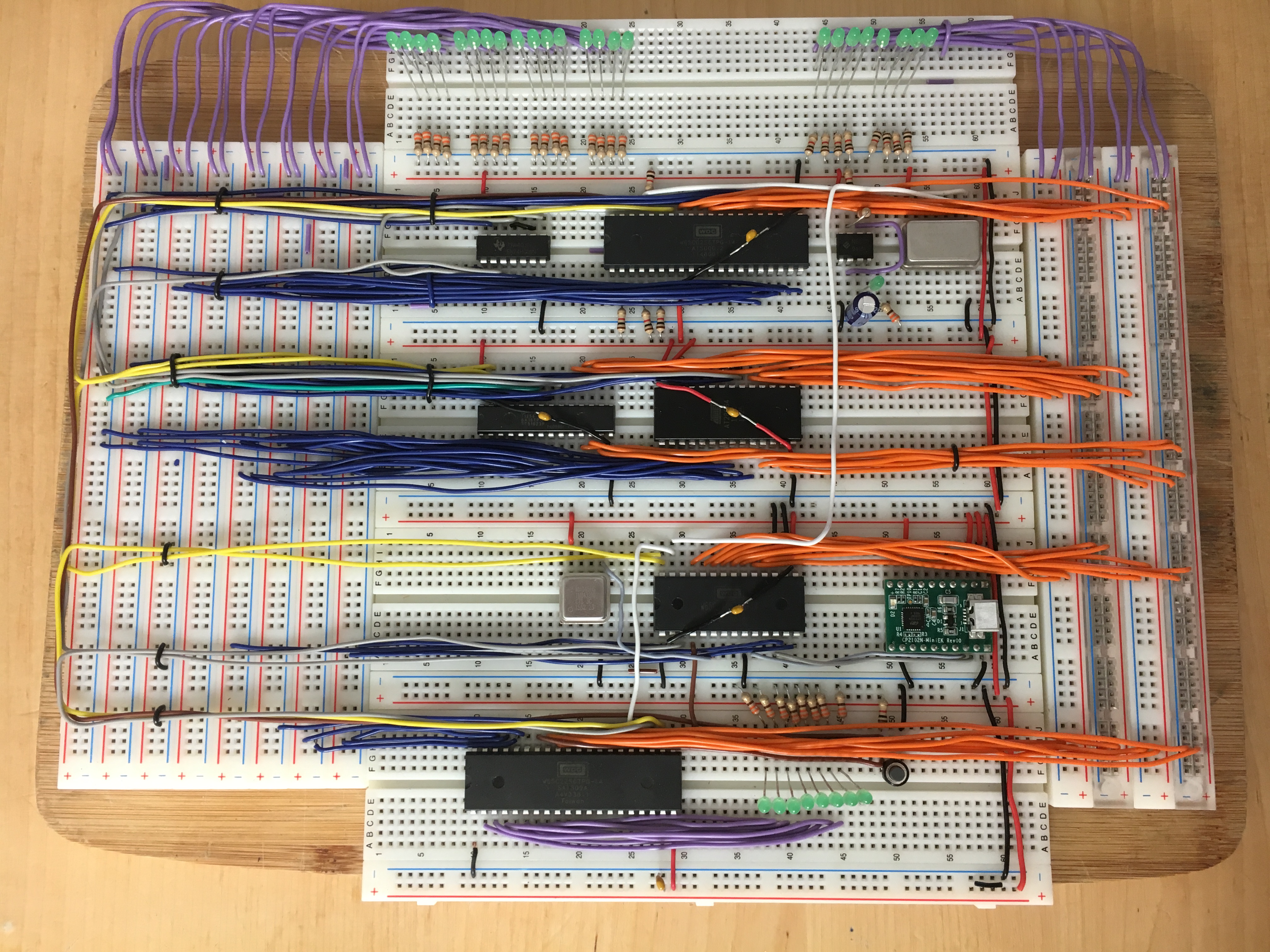

This is the current status. I will optimise the ground connection and the write control cables.
For me it is a learning computer. I know it is not optimal.
I am now thinking if the next step could be to enter a little program via terminal which will be stored and executed in RAM.

PostPosted: Sat Aug 12, 2017 3:10 pm
Posts: 213
There is only one bit difference between upper and lower case.
You can use a 'or' mask or 'and' mask to change that bit. That
way your program will be case insensitive. That is a lot handier.
Do be careful to make sure it is a letter first and not a number.
How are you going to enter values? Most like Hex but it requires
converting to a byte value. It could be in binary for a start.
Also you'll need a way to error out and reset the address to the
desired location.
Tinker Dwight
