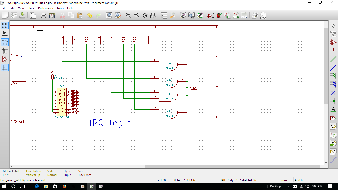

Here is the amended version, taking you guy's advice into account.

Dang, just realized another goof. Pretty sure I can't just connect all the AND outputs like that. Probably why it was suggested I feed the outputs of two ANDs into the input of a third.
Means I'll have half as many IRQ lines, and a wasted gate.
Is that my best play?
Why are you making it so complicated? A device with a totem-pole IRQ output, such as the W65C22S, can drive a wired-OR IRQ circuit through a Schottky diode. Why mess with a bunch of gates like that?
In any case, you can't wire the outputs of the gates together in that fashion. If one gate tries to drive /IRQ low while the others are driving /IRQ high something is going to get broken.

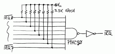

How 'bout something like this. The 74HC30 gives you 8 inputs, if you can spare an inverter function somewhere (even like from a spare NAND in a '00):
Each individual input can still have several open-drain (or open-collector) IRQ\ outputs at once. They can also handle totem-pole IRQ\ outputs. It's just that if there's a totem-pole IRQ\ output on one of them, that one will need to be alone, not sharing the input with any others.
There's also the 74HC133 13-input NAND gate.

I already realized in my haste I foolishly connected my outputs (as per my last post). We're past that. :wink: I'll sacrifice half the lines, and feed two gates into one, again, as mentioned earlier.
As for the S variant of the 6522, I don't have those on hand, nor any Schotky's. I do have some 74HC08s.
As for the complication of the switches, I already stated my desire for hardware control of whether a particular chip's IRQ line is online. I can think of a few reasons I'd like that capability.
This is going to be an intermediate prototype board, not the final computer. Thus, I want flexibility so that I can try things. An IRQ circuit that can handle pretty much any type of output stage, and is switchable fills that bill with very little hassle. The resistors and switch bank are trivial to include.
PostPosted: Mon Aug 07, 2017 2:14 am
Posts: 276
Location: Lynden, WA
Garth, I'll have to see if I have that chip. I don't NEED 8 lines, it was just a by-product of my initial wrong move of joining my outputs, and wanting to us all my gates. If I use that 7408 properly, I'm down to four gates, but as you said, only totem-pole output stages need their own line. I could put more than one ACIA on a single line. Anyway, 4 should be enough.
I also really want the switches, for previously mentioned reasons. Imagine thinking you had an interrupt related problem, and as you sat there, all you had to do was turn off that interrupt with a switch to test the theory (instead of going through the hassle of re-coding and re-writing a ROM on a hunch). Also, I can think of reasons to want to switch UARTs on the fly during development.
The switches would be unlikely to be in the final build. Think of them as a debugging tool. I've already had issues where they would have saved me time!
I will see if I have that 8 input NAND. It would be better. Heck, I'm ordering dip switches, so adding a logic chip or two is no big deal. I have an unused NAND on my address decoding 74HC00, so I already have the inverter.
