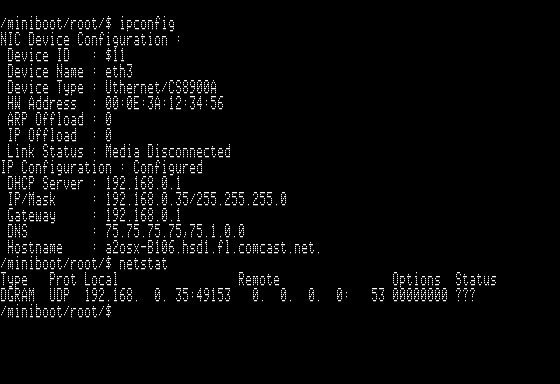

As seen elsewhere, an announcement and request for contributors and testers, an OS based on "a cooperative, event-driven multitasking kernel", "including IP Stack & HTTPD/TELNETD..., GUI & graphical tools":
A2osX is designed to work on any "stock" 128k Apple //e, with no additional hardware. As VBL signal is NOT available as an IRQ on //e (it is on //c & IIgs) it makes preemptive multitasking impossible.
Kernel, loading in Aux LC on top of ProDOS provide API inspired from Linux/Unix World to allow writing applications & command line tools on top of it. This kernel provides an advanced "Memory Manager" able to relocate 65c02 code. "Event Manager" makes TCPIP stack able to listen on several ports, manage ARP,DNS...cache expiration and any background processes. "Task Manager" is responsible to "distribute" CPU time to several loaded processes. "Device Manager" handles event collected from builtin devices as well as devices added by loadable drivers.

As far as testing goes, just download the boot disk image, put it on your real Apple IIe or IIc or IIgs (not emulator) and report back what happens when you try the different command line utilities. We need people to test various hardware configurations, including RamWorks, clock cards, Super Serial cards, LanceGS and Uthernet cards. There is also going to be support for the AppleTalk workstation card, so if you have one of those for your IIe, you will be asked to test your configuration.
