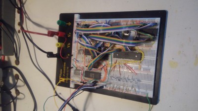

Now that I've got the root hardware up and running, my project is at a crossroads.
My next hardware goal is to no longer need the terminal connection to the PC. Keyboard should be simple enough. Just finished looking over the PS/2 protocol, and it's fairly straight forward. Video is still in the decision making stage. Garth brought up SPI controlled graphics displays. I like the sound of that because it is a good mix of diy video, but not completely from scratch. I see that method as a bridge to an eventual true VGA or composite from scratch interface. Fits nicely with the whole incremental complexity thing I'm going with.
Software is probably my most immediate goal. I'm torn between modifying an existing monitor/OS, or rolling my own. The more I ponder it, the more rolling my own sounds appealing. I am leaning that way. Since this computer is just a goal into it's own, I'm in no real hurry, so the instant gratification of dropping something premade in ROM doesn't really matter to me.
Honestly, I thought getting to the point of having a working build would be allot tougher/longer road. The only real hiccup has been a self-inflicted wound from a rookie misread of a data sheet. I got the hardware up and running ahead of schedule, so my study of 6502 assembly needs to catch up!
Here is a current pic:
