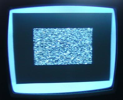

Wanted to share an old but useless little gimmick:
192*96 pixels, black\white, ca. 20 frames per second, generated on a C64.
While spending two months without internet because of a broken arm,
I eventually found the time to scrap my collection of ca. 400 3½-inch floppy disks.
One of the disk labels remembered me back to the time when we did some 80x86 assembly
coding in a "DOS environment" at tech school... back in 1997. As time goes by.
At some point, I had felt a little bit bored, and just for the fun of it I had tried
to generate something that looks a little bit like video noise on the PC screen
with 48 Bytes of machine code or such.
Luckily, I still had a version of that 20 years old code printed on paper,
and because I recently felt bored again, I couldn't resist to try an implementation on the C64.

Now for my attempt of making a C64 implementation.
Code would have been simpler when generating a 320*200 picture.
Problem is, that the speed breaks down to not much more than 6 frames per second
when the C64 has to generate a picture that big.
But the optical effect on the screen won't look nice for less than 20 frames
per second, so I decided to use a smaller picture for increasing speed.

192x96 is the same number of pixels as a 24x12 block of characters, which is 288 of them. 256 isn't much lower. So... fill the screen with 256 different characters in some random pattern (you don't want any regularity in the layout, but you also don't want the duplicates of one character to occur too close together) and fill their definitions with your random numbers. Voila! A full screen of 20Hz snow.

Yeah, that was my thought. Lay out the character map in some pattern that's irregular enough to not break the effect, and you can generate a much smaller amount of noise and still give essentially the same effect, for purposes of human perception.

That's very fast for what you're doing. I hate to say this, but I've seen demos with video noise, and I'm pretty sure they just set the sound chip to produce noise and read the waveform register. You can do this in realtime and fill most of the screen with noise.
The sid chip does a 23 bit lfsr generator in hardware.
http://www.oxyron.de/html/registers_sid.html
PostPosted: Fri Mar 24, 2017 8:06 am
Posts: 1431
@Jeff: thanks for the warm welcome. I'm still a bit slow with typing... might be getting better in half a year or so.
@repose: when spending some more thoughts on this, I'd say you are right about that using the SID LFSR would be a better approach for generating noise on the screen.
Thanks for telling me.
Anyhow, out of sentimental reasons I just wanted to know how that old piece of x86 code performs when getting ported to a ca. 1MHz 6502.
I somehow just never found the time to make a try during the past 20 years. :)
