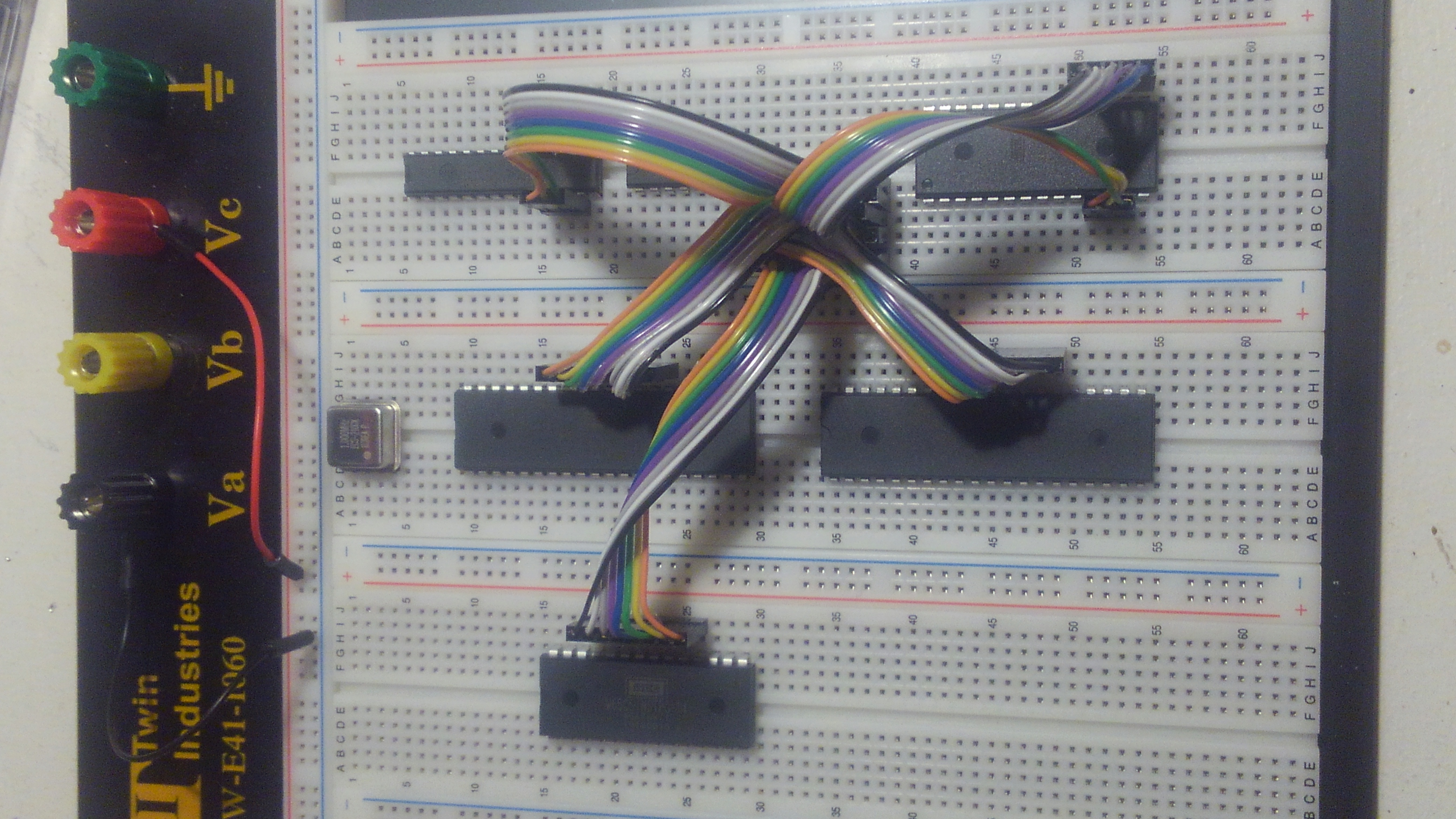

Data bus is finished. Totally happy with the decision to make custom ribbon cables. Not only is it clean, it completely eliminates any chance of getting lines crossed. I really want this thing to be ready to debug.

I look forward to seeing what happens next. I am optimistic, but it's notable that this style of construction might be a worst-case for electric signal integrity. Please do proceed and try it - don't be put off - because we will all learn something here.

I'm only running the thing at 1 MHz.

That should certainly help. But, for example, if a clock signal is unclean, then frequency isn't the main concern - it's whether any receiver sees an edge which isn't there. I think if clocks and strobes (if any) are clean, and there's enough bypass caps near to the chips, there shouldn't be a problem. Synchronous design is a wonderfully forgiving world!

Keep in mind that it's not about the clock requency, but about the rise times and how the circuit reacts to them. In digital electronics, the rise time is independent of the frequency. In Jack Ganssle's YouTube video, "I Only Probed the Board With a Scope - Why Did My Board Crash?," the part from about 2:20 to 3:00 graphically shows on an oscilloscope that the ugly ringing remains unaffected as he turns the clock frequency up and down. (This is in the "Construction: Avoiding AC-Performance Problems" chapter in the 6502 primer.) The ringing will be worse, with greater amplitude, in a solderless breadboard, and can double-clock (or triple-clock, etc.) the processor, VIA, etc. with not enough time between pulses to react completely, and make it crash. Depending on the circuit, these unwanted pulses' apparent frequency may be 40MHz, 50MHz, or other frequency too high for these parts to work right. This is why the most important signal to keep clean is the Φ2 clock signal.

Doesn't matter if the Ø2 clock signal when seen on a 'scope looks like the Chicago skyline. :D
Amen to that, which is why I go to considerable trouble to lay out the board so the Ø2 signal path is as short and direct as I can make it, especially if more than one device is using Ø2, e.g., a CPLD or a couple of VIAs.
Using a 74AC74 flip-flop to generate the actual Ø2 signal helps, as the flop's output is "stiffer" than that of a can oscillator (a 74AC74 can source or sink 24 mA), plus produces a symmetric output, which becomes important as the clock speed approaches the MPU's maximum rating. However, a stiff signal is not a substitute for a proper layout.
Everything going on in a 65xx system is ultimately slaved to the Ø2 clock. If you can't get Ø2 right your machine will be, at best, unstable.

I think I can get a pretty enough clock for this. I have with micro controller projects on similar bread boards. That is an analog problem, an area I have much more knowledge in than digital! My first move is to get the clock running and scope it. I'll send a pic of that when I do, with the relevant measurements on screen. You guys can tell me if I'm good I imagine.
