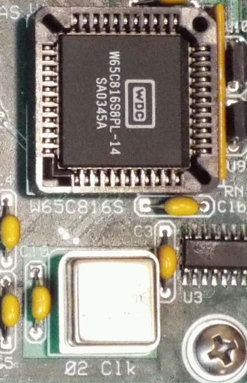

That item appears to be Jameco part number 27861. As far as the output of that oscillator goes, Jameco's page for it does not indicate whether its output is TTL or CMOS. I'd be cautious, as the 65C02 and 65C816 are somewhat fussy about the characteristics of the Ø2 clock signal. As Garth suggested, you could run its output through a 74ACT gate (AND, OR, etc.) and give the signal a boost. A another solution would be to use a 2 MHz oscillator and run it through a flip-flip, which will both strengthen the signal and assure exact 50-50 symmetry.
Two other points: firstly, depending upon your location, it may be a bit cheaper to order directly from Jameco's website. Secondly, a half-can oscillator has the same functionality but occupies about one-half the space of the full-can part you are looking at, plugging into a DIP8 socket or one of those made-for-half-can-oscillators sockets. Here's a suitable part at Mouser Electronics, but in a half-can package, and with output that almost swings rail-to-rail, more than satisfying CMOS input requirements (VOH is 4.5 volts minimum). I use the same part, though at a higher frequency, in my POC units. The below pic shows the Ø2 clock oscillator in POC V2, mounted in a compatible socket. The SOIC14 chip (U3) to the right of it is a 74AC74 flip-flip, which is used to condition the oscillator's output. Hence Ø2 is one-half the frequency of the oscillator.
