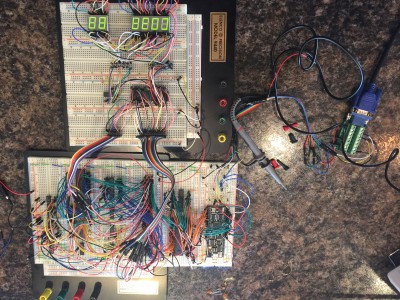

Hello everyone! My name is Craig, an avid electronics hobbyist. I'm brand new to the 6502 scene and have been working on the following project for the last 3-4 weeks. The DANI-I 6502 Microcomputer (named after my wife Danneille). Without further ado - here are the pictures with some explanations.
From left to right
Xilinx Spartan 3A - Used as the custom made VGA Controller - Called DANI-I VGA
Output is VGA @ 640x480 60Hz - but the pixel area is 320x240 or a 40x30 tile display of 8x8 tiles, with 16 sprites. 6bit Resistor DAC (64 Displayable colors) 2 Colors per 8x8 tile (for time being)
The the Right of that on bottom is 32Kb of Video RAM, it holds all the Tile and Sprite Data. Above that is the screen Index buffer and VGA command register which is 4k of Dual Port Ram. The Left port is accessed by the FPGA at 25mhz and Right side is accessed by the 6502 at 4mhz. During HSYNC optional commands can be sent to the VGA controller for storing or retrieving tile and sprite data, screen data can be accessed at any time.
In the middle is the address bus and data bus (I know im gonna get hate for doing this on a breadboard, but hey - it's what i had :) )
Next starting on the bottom is the main system SRAM Chip, 32Kb of it - above it is some address decoding and glue logic.
In the next column we have a reset circuit on top - it consists of a Hex Inverter and a 555 circuit for reset.
Below the Hex Inverter is the 6502! (So glad I went with this chip - it's been amazing) Below the 6502 is the ROM it's 32Kb but only 16Kb of it is accessible.
On the far right is nothing special yet... it's just glue logic for the additional IC's i will be adding this week, including the 6522.

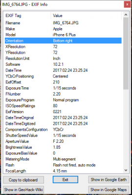

ChaseHQ85 wrote:
And of course all the pictures are upside down... :evil:
It seems to depend on the browser. Edge displays both preview and magnified image upside down. In Firefox only the preview is upside down and the magnified image is correctly oriented.
EXIF Orientation should be top left. There is no EXIF with the preview, so it cannot be corrected.
