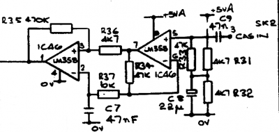

The cassette tape on my Atom was fairly reliable, as long as you played them back on the same recorder. Exchanging tapes with friends often didn't work, but could usually be fixed by adjusting the angle of the recording head by turning a little screw. Of course, once you started messing with that, there was no going back, as each recording was done with a different angle.
Attached schematic of analog input section for the cassette tape. They used a simple FSK encoding, and the decoder simply counted the number of cycles between zero crossings.
