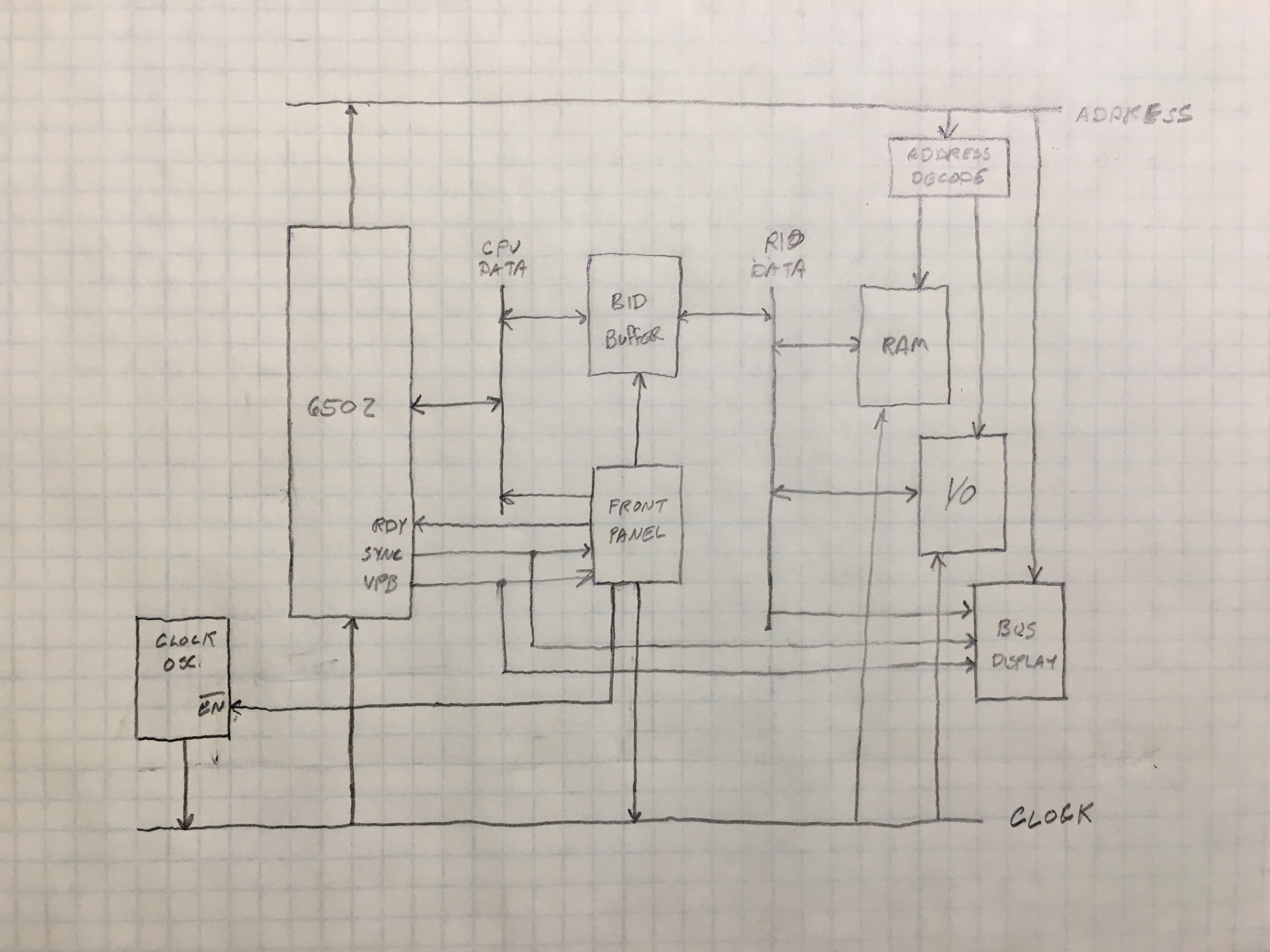

Done traveling for the holidays, and still thinking about the front panel design. Here's a block diagram of how I think it will go at this point. I want to keep the clock local on the processor board, so the front panel will inhibit the processor clock and generate its own clock pulses for its actions. (probably at a kHz rate instead of MHz.)

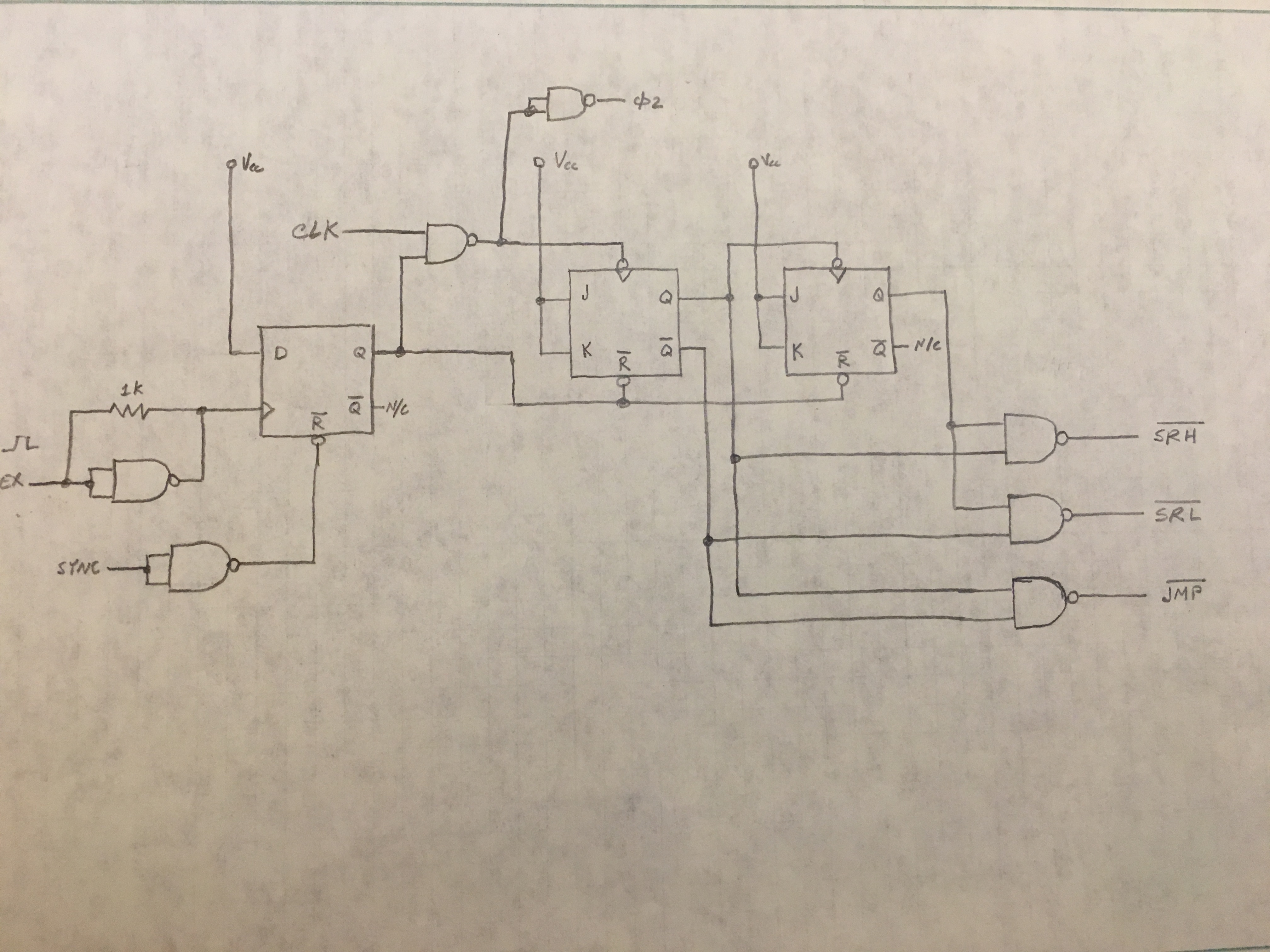

Still here, still working on the front panel concept. Life of course has intervened, with the early sale of my house and delays for my new house causing all my hardware and tools to be in storage! So, this is a paper exercise for now. I do have a bit to show, the attached photo is a partial design for the examine circuit that jumps to a location in memory. I'd been thinking of stopping the clock to halt the 6502, so there are a few gates for that in this schematic. I think I'm going to go to de-asserting RDY instead, so I don't have to gate the clock all over the place or run a second source. The outputs will go to the /OE inputs of a series of '244 tristate buffers to provide the appropriate bytes to the bus in turn.
