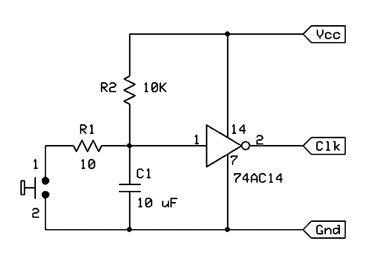

Nice job on the schematic. I haven't examined it in detail but I did notice you have the IRQ\ outputs of the UART's tied together and (apparently) feeding an input of the 16V8 PLD. Are those IRQ\ outputs open-drain? If so then you need a pullup resistor. And if they're totem-pole, not open-drain, then they shouldn't be tied together -- you need a gate. BTW you haven't told us what equations the 16V8 contains, so in that sense the information is still incomplete.
Regarding troubleshooting, visual inspection and continuity tests are valuable but they're not your only options. An alternative approach is to remove the oscillator and temporarily attach a manual clock generator so you can single-step. [I see Klaus also mentioned this.] The clock generator shown below inverts its output every time the button is pressed. (IOW two presses results in one clock cycle.)
Single-stepping requires patience, and you need to think in terms of the cycle-by-cycle behavior of the CPU. But it's a powerful technique, and it doesn't require an oscilloscope or other fancy test gear.
As for understanding the cycle-by-cycle behavior, that's actually a valuable learning experience -- and you don't need to tackle it all at once. For example, you can begin by verifying that the ROM gets selected -- something that you know should occur shortly after reset even if you don't know the exact cycle count. (In case of any doubt the CPU's VPB output will reveal when the first two ROM access cycles should occur. :wink: )
Once the ROM is selected you can verify that the low-bye of the reset vector appears on the data bus and reaches the CPU. Then you proceed to the following cycle when the high-byte should appear. It's all step by step. The cycle after that should be the first opcode fetch (remember SYNC is high for all opcode fetches, so that helps you keep track). Again you'll verify that the data bus carries the expected value. You may also wish to check the address bus, whose value should be the same as what's stored in the two bytes at the reset vector.
Eventually you'll find a result that isn't as it should be... and that's the clue that will reveal a problem. Begin with a simple program such as a loop that simply jumps to itself forever. If that's alright, try adding a LDA that accesses one of your I/O devices to see if the device's chip-select activates properly. And so on.
Remember at the start you'll need to keep the CPU reset pin low while you apply a few preliminary clock cycles. *After* that's done you can bring reset high and proceed as noted above. In order to control reset you may wish to make an extra copy of the push-button circuit. (You could make as many as three, using just a single inverter IC. :) )
BTW I think the circuit will work with 'hc04 as well as 'hc14. It's a circuit I learned decades ago but I haven't built one recently. The parts values aren't especially critical. The 47K resistor completes a feedback loop that keeps the two inverters in whatever state they're in. Meanwhile the capacitor gets charged to a value that will oppose the existing state. Pushing the button causes the capacitor to override what the 47K resistor says.

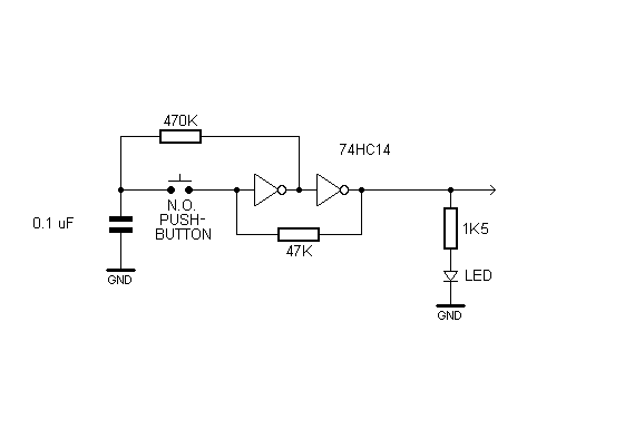

I have tried manually clocking it with a schmitt trigger NAND gate and a DPDT toggle switch, but this seems a lot neater. I should probably get a small strip-board and build up a single-cycler like that, but with a reset switch on there as well. I know that I have a hex inverter in 74HC, whatever it is.

Toggle switches are fine -- whatever works for you. But of course pushbuttons tend to be much smaller and easier to mount than toggle switches -- also less expensive.

Nice circuit, Jeff. The electronics industry will be quite miffed with you for using so few parts to get the job done and thus negatively affecting profits. :P
