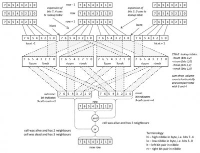

File comment: Data flow in Life88, drawn by DaveB

A couple of things stand out for me, having looked a bit more at the Life88 diagram
- the extreme benefit of using lookup tables to transform a byte into a byte (I think there are 7 page-sized lookup tables in the code)
- the clever avoidance of shifts, in marshalling the partial bytes into the appropriate collections, to deal with the overlapping windows
I think perhaps the trick with a fast Life - arguably, with any fast algorithm - is to do as little computation as possible. Because Life uses overlapping 3x3 windows to calculate each cell, a naive approach will be doing the same work several times.
Xlife-8 uses 8x8 tiles - figuring out what happens in the interior of a tile is probably quite efficient, but there are 8 neighbouring tiles, the edges and corners of which have to be brought into play. It still wins on speed, but only manages a relatively small universe. It's possible it could be enhanced.
I've got to the point now where I can try the three different algorithms with arbitrary RLE patterns:
- Atom Life
- List Life
- List Life with 8-bit chunks using the Kernel of Life88 for computation
What's rather surprising is that the original list_life is actually a bit faster than the chunked version.
Running the "rabbits" pattern to 17400 generation:
- List Life takes 71s (245 generations/sec)
- List Life with 8-cell chunks takes 82s (212 generations/sec)
(On a 225MHz 6502 Co Pro, with rendering turned down to once every 32 frames to focus on just the life algorithms)
This is somewhat of a surprise, as my cycle counting lead me to believe the Life88 kernel would be about 3x faster.
As an estimate of the kernel complexity, I had simply counted 6502 cycles:
- List Life is 112.5 cycles (per cell)
- List Life with 8-cell chunks is 266 cycles (per 8 cells)
When I compared these a few days ago, I had rather simplistically just multiplied the List Life figure by 8 to make them comparable. Doing this suggests moving to 8 cell chunks should be 3.4x faster.
Unfortunately, it isn't.
To better understand this, I've added some instrumentation to the C version of each of these algorithms. This counts the total number of times the kernel of the algorithm is executed.
- List Life executes the kernel 109,115,829 times
- List Life with 8-bit chunks executes the kernel 49,264,473 times
Translating everything to kernel operations per generation:
- List Life: 6,271 ops per generation
- List Life with 8-bit chunks: 2,831 per generation
For me the real surprise here is the ratio of the number of times the kernel is executed between the two algorithms. I had expected 8:1 and its more like 2:1.
The average number of cells per generation is 1,246.
Using these numbers, the total number of 6502 cycles should be:
- List Life: 112.5 * 109,115,829 = 12,273,530,762
- List Life with 8-bit chunks: 266 * 49,264,473 = 13,104,349,818
Dividing by a 225MHz 6502 clock speed gives:
- List Life: 112.5 * 109,115,829 = 54.6s (actual was 71s)
- List Life with 8-bit chunks: 266 * 49,259,965 = 58.2s (actual was 82s)
The difference compared to the actual is because there is obviously more than just the Kernel being executed.
There is still a mystery here, which is why is the original life88 implementation (within a 1Kx1K universe) so much than list life comparable hardware.
It's possible we are still missing an important optimization.

To compute the future of a 4x2 patch you need to consider a 6x4 area, which means a 16MByte lookup table. That's a lot, even with banked memory, although it made our C prototype fairly straightforward to code. If instead we consider the two 2x2 halves of the patch, each of which has a 4x4 ancestor, we need to do two lookups in a 64k nibble (or 32kByte) table - large, but more manageable. We had a look at that, and it looks like it should be very fast, but we actually went one step further and take four lookups in a 4kByte table instead - it's not quite as fast, but is much more compact.
We now take well less than 200 cycles in computing the next generation of a 4x2 patch, but there's overhead in traversing the data structure so the average performance overall is 354 cycles per 4x2 operation. We could probably knock 50 cycles off that by moving from 4k to 32k table.

PostPosted: Wed Nov 23, 2016 5:02 pm
A simple idea would be to replace your lookup tables with a logic expression implemented in the FPGA, so you could do the same thing you're doing now, but without having to deal with huge tables.
PostPosted: Wed Nov 23, 2016 5:09 pm
Posts: 10793
Ah, of course - 24 bits in, 8 bits out, just a big mass of logic in between. But it's all quite simple stuff, so single clock cycle for sure.
Edit: even quicker if it's 32 bits in, 8 bits out!
PostPosted: Wed Nov 23, 2016 5:12 pm
Posts: 10793
Actually I'm almost tempted to consider a writeable control store approach, using distributed RAM to control a function generator which maps 32->8 bits and has enough generality to compute a Life algorithm. Like having an FPGA in your FPGA.
