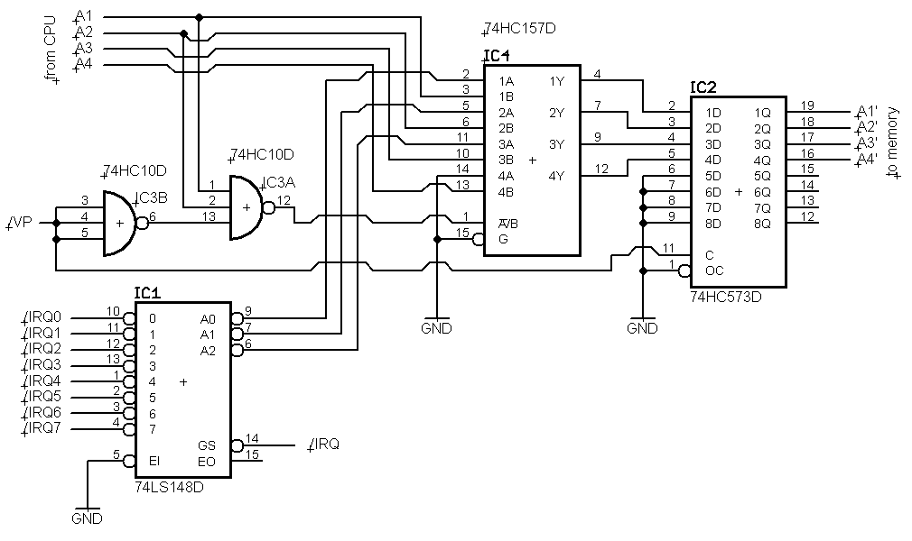

PostPosted: Tue Oct 25, 2016 9:27 am
Posts: 1429
Sorry for unexpectedly bumping in...
about having IRQs with different priorities:
Suddenly, I feel reminded to the Synertek Hardware Manual, page 120 (labeled page 107 in the PDF).
"Quad 2 input data select" -> 74HC\HCT157
"priority encoder" -> 74HC\HCT148
The concept looks pretty simple...
But when building it that way, I would be afraid that a IRQ with a higher priority might go active
between fetching the low_Byte and the high_Byte of the interrupt vector.
Edit:
If all of the 8 IRQ vectors would be pointing into the same 256 Bytes page in memory,
the high_Bytes of the vectors would be identical, and there would be nothing to worry about...

PostPosted: Wed Oct 26, 2016 6:33 am
Posts: 1429
What the priority encoder is doing is producing an eight bit index.
So your ISR would start by pushing the registers as required and then loading the interrupt index into, say, .X.
Sorry, the ISR isn't involved.
From what I have figured so far, the basic idea of the schematic from the Synertek manual seems to be
to decode when the CPU reads the memory addresses in the ROM which contain the IRQ vector.
If the CPU reads those two Bytes in memory (while responding to an IRQ for instance),
a 4 Bit 2:1 multiplexer is used for tweaking some of the address lines to make the CPU read
from different memory locations.
The priority encoder then selects from which memory locations the IRQ vector is fetched
according to the IRQ level.
Don't forget that upon responding to an IRQ the MPU will do the equivalent of an SEI instruction
after it pushes PC and SR, thus preventing the pending interrupt from being interrupted by another IRQ source.
True, but unfortunately this doesn't affect the priority encoder.
For instance, if /IRQ6 at the 74148 priority encoder input is active, and the CPU starts fetching
the IRQ6 vector, it reads the low_Byte of the IRQ6 vector.
If /IRQ7 goes active shortly after the CPU has fetched the low_Byte of the IRQ6 vector,
the encoder would generate the address for fetching the high_Byte of the IRQ7 vector,
because IRQ7 has a higher priority than IRQ6.
Would suggest to place a 74574 latch clocked by SYNC at the inputs of the priority encoder,
this probably would fix this problem and the 74148 would have nearly one CPU clock cycle of time
(minus SYNC setup time and the other setup and propagation delay times etc.) for decoding.
// Maybe 74573 might work, too... somebody please post the schematic after building something like that.

PostPosted: Fri Oct 28, 2016 1:31 am
Joined: Thu Jun 04, 2015 3:43 pm
Posts: 42
ttlworks wrote:
Incidentally, priority encoders are relatively slow devices, as they have a lot of gates.
Priority encoding is a good job for a PLD.
74F148 seems to be out of production, and there seems to be no 74AC\ACT148.
BTW: maybe 20ns propagation delay at 5V for a 74HC148 from TI.
The datasheet says that for a HC device, all signals are under 40ns at 25°C. What on Earth are you people doing that makes a 40ns delay for an interrupt an issue?
But another problem is to decode when the CPU tries to read the memory addresses containing the IRQ vector.
I presume that the vectors are where they are specifically to simplify decoding. Decoding the addresses FE and FF (for the IRQ vector) is just a matter of one 8-input (N)AND gate, and decoding page FF uses another one.
But of course on WDC silicon, you have the VPB output, for which the datasheet explicitly mentions interrupt vectoring as the intended use. Again, IRQ is the highest vector, so that decoding it can be done with just one gate.
The inputs to the priority encoder changing their state is still going to be a problem, since the signals are potentially asynchronous to the CPU's interrupt handling and we might be reading the outputs as they are changing, which might give invalid results. Ideally, you'd want to freeze them when fetching the vector, but I don't see an easy way to do that; by the time we know that vectors are being fetched it's too late. (Too late, unless we're latching the inputs on VPB and switching the high 8 bits of the address... But wasn't the "early interrupt warning" idea pretty simple, as in just one or two flip-flops?)
PostPosted: Fri Oct 28, 2016 6:06 am
Posts: 1429
Well, if your CPU would be running at 20MHz, one clock cycle would be 50ns,
and a 40ns delay probably would be an issue then... ;)
That's all "implementation specific"... and a "homework assignment" for somebody who might be
trying to build something like this, in other words, it's not "my homework assignment". :)
Of course, decoding the vector fetch will be a bit more more in the time critical signal path
than decoding the IRQ level, because vector decoding plus address multiplexer switching delay

Priority decoder output better should be stable when the multiplexer switches, that's all.
Else, some of the priority decoder delay would add to the memory read delay.
I see, I misread you when you said it was "a problem".
Should have phrased it more clearly and detailed, sorry. :)
You just get rid of that 15-input AND gate, substitute /VP for its output and switch the A and B inputs on the mux
(since /VP is active low rather than high).
/VP also might go active for RES and NMI, so we need to check if the address lines A1 and A2 are '1', too...
the multiplexer shouldn't try to map RES and NMI to 8 different vectors.
Right, we'll need that latch, without it we might get invalid outputs from the priority encoder;
We'll need that latch.
Clocking it with SYNC probably won't increase IRQ response time, but to me this looked like the most simple solution.

Had some spare time on my hands, so I tried to draw two schematics.
It's been a few years that I had tinkered with a 6502,
and it wasn't a W65C02, so I don't know if this will work as intended...
Since the interrupt vector address has to be stable during vector fetch,
I'm now using a 74573 latch which freezes when /VP goes active.
Because of the dinosaurs among the readers, I'm posting monochrome schematics:
/IRQ7 has highest priority.
/IRQ7 -> $FFE0,1
/IRQ6 -> $FFE2,3
/IRQ5 -> $FFE4,5
/IRQ4 -> $FFE6,7
/IRQ3 -> $FFE8,9
/IRQ2 -> $FFEA,B
/IRQ1 -> $FFEC,D
/IRQ0 -> $FFEE,F
...If anybody has a better idea or knows how to improve this,
please post it here.
