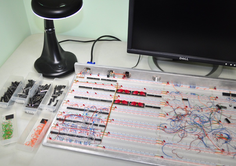

I have recently ripped up every last wire and chip, so I am truly starting over now.
.... bring it on!
Radical Brad

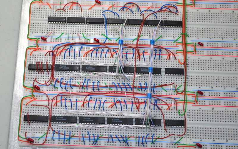

I did take an hour to rip up 90% of the two breadboards for my Vulcan-74 Reboot.

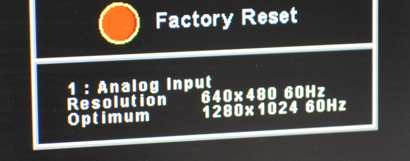

The only thing I left was the original VGA Frame Generator, which has been reconfigured to 640 x 480 timing...
This circuit generates both Sync Pulses, and the Blanking Periods.
Being made of self contained modules, each section of the circuitry is able to run independently.
So, the VGA Monitor still thinks it's getting a valid signal, even with only this section remaining...
With a valid Horizontal and Vertical Sync, the monitor is happy to display a blank picture.
The original Vulcan-74 design called for 400 x 300 resolution, but I found a way to get 640 x 480.
This pushes the breadboard timing about as far as I believe it can go, which calls for the maximum propagation delay to be under 40 nanoseconds through any path. To make this magic happen, I have made several changes to how the VGA Generator works.
Originally, there were four 590 counters driving both the comparators and frame memory. Two counters were used for X (400 pixels) and two for Y (300 lines). To switch between the dual buffers, the counters were fed through dual banks of 74HC574s, cross-wired to act as a large address switch. The VGA Generator had one bank, while the GPU had the other.
in order to meet the insane 40ns maximum delay, I had to remove the address switch and come up with another alternative.
Interestingly, the result was a much cleaner pathway, and one less IC required.
instead of switching the counters through the buffers, I just used the OE lines on the 590 counters, and added 8 more of them!
So now the VGA Frame Generator has its own X/Y counters, and so does each of the Video Buffers.
Sound confusing?? here is how it works...
VGA Frame Generator : X/Y counters always running, and driving the comparators directly.
VGA Buffer One : X/Y counters enabled while GPU has control of Buffer Two.
VGA Buffer Two : Input Buffers enabled while X/Y counters have control of Buffer One.
Buffer Switch : Invert the state of Buffer One and Two during the next Blanking Period.
All counters share a single reset line for X/Y wrap, so they are always in sync.
A schematic will show this when i have time to make one up.
So here is what I am starting (again) with...
Getting ready to insert the Dual Buffer Memory into the design.
Notice that I now require four 512K 10ns SRAM chips for the VGA Generator.
Since 1024 x 480 x 2 x 2 requires 1,966,080 bytes, I need 2 megs of RAM for dual buffers.
Explanation of 1024 x 480 x 2 x 2...
Since the X/Y counters are bit based, to count to 640, that requires 10 bits, which is actually 1024 bytes.
So the SRAM is setup as 10 bits for X and 9 bits for Y.
Because I am now sending 12 bit color with 4 special bits, I need double the SRAM for a 16 bit data bus.
I plan to connect this all up and then stuff a 640 x 480 image with 4096 colors into the Memory using an AVR for testing.
If the image is clean and stable, I will proceed with the rest of the design.
This is really going to push the realm of the breadboards to a new level if it works.
The "slowest" signal that will be used will be 25.175Mhz in this design!
Photos and a video of the first image test coming soon.

The compression is actually very basic, and almost a side-effect of the new alpha control system.
When I decided to use one of the spare bits to wrap the X-Source counter, I realized that it could be used to wrap the X counter early if what remains was only alpha pixels.
And since most Sprites have a large number of alpha pixels around the center (think of a ball in a square), then wrapping at the end of the last visible pixel simply saves that number of useless pixel clock cycles. In a series of animated Sprites (like the checker balls), this is a significant savings.
I have had no lab time, but much time to consider the new re-design, and have made a few more design goals...
There will be only a single HUGE graphics memory, and the function of Sprite Generator and Playfield Generator will now combine.
This will now be called simply "The Graphics Memory", and it will be a whopping 4 Megabytes in size (512K x 8).
I know... 4MB??? that ain't even the size of a two word PDF file, but in this case, it is a goodly amount of memory!
I also intend to address this memory in an X/Y fasion, having 11 bits for X and Y. The result will be a massive 2048 x 2048 bitmap.
Sprites and scrolling screens will just be address as blocks of memory.
Still hoping for a speed increase as well, perhaps 10MHz pixel bandwidth.
Can't wait until I get another free day to try out some ideas.
Brad
PostPosted: Wed Nov 16, 2016 2:03 pm
Posts: 670
Sometimes being away from the hands-on part of a project is good, as it offers time to really consider all options.
I have added one more goal to the redesign, which should start next week when the snow drives me indoors again.
Might as well go all the way.... 24 Bit Color!
This might sound far-fetched for a logic based VGA Generator, but all I really have to do is add afew more ICs (SRAM and 7400 logic) and a bunch of resistors in order to achieve a display capable of 16,777,216 colors.
Instead of doubling up all of the graphics memory to get 12 bit color, I am instead going to have 8 bits internally feeding a 24 bit Palette lookup SRAM. The Palette memory will be three fast SRAMs with their first 8 address lines tied together to produce a 24 bit wide, 256 Byte SRAM. Being SRAM, the Palette will be fully programmable by the 6502 so that 256 colors from a palette of 16 million can be displayed at once.
There are several reasons this is better than using a 12 bit (4096 colors) palette all the way around internally...
- Graphics memory usage is cut in half. So 8 SRAMs becomes 4MB rather than only 2MB.
- Palette can be made uniform for color swapping. 16 sets of 16 colors, 8 sets of 32, etc.
- Antialiasing will be much better with 16 million available colors.
- Single pixel operations from the 6502 will be many times faster.
For the triple SRAM Palette Generator, I may even be able to get away with some 32K 15ns DIP SRAMs I have sitting around.
I will have to add 2 more levels to the output pipeline, but that has no effect on the VGA generator, which is 3 levels deep already.
Ok, that's it for my features list until I wire this all up to see if it's going to work.
My next report will include photos of messy wiring and screenshots of the results.
